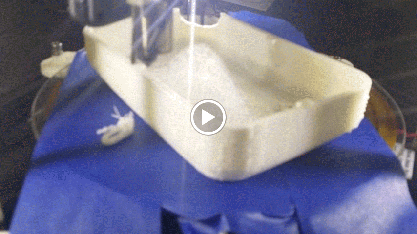

I have a delta running marlin. Any ideas as to what’s causing the blobs. I think its a setting that’s causing the printer to pause periodically but I’m not sure which one that is.
What slicer? The slicers may either pause or slow down to ensure that current layer cools before starting the next layer.
Cura
Good theory I’ll test it
Another reason for such blobs is moisture in the filament. The filament would essentially expand after leaving the nozzle. If you hear popping or hissing noises when the printing is going on, you may have the temperature too high and/or there is moisture in the filament.
Naw no hissing or piping I keep my stuff pretty dry. I’m hooking op a fan to the hot end so I can cool the print and disable that setting for a test
Lemmie know what you find. Mine does it, too.
I had similar and took the temp down 5 deg and cleared mine up
Thanks that solved my issue
well i though that solved it, most of them went away. i’ll try a temp bump down and see if that takes care of the rest
Don’t be surprised if getting rid of the little blobs results in the inability to bridge properly. I am not saying it is guaranteed, but there is a chance of that result.
