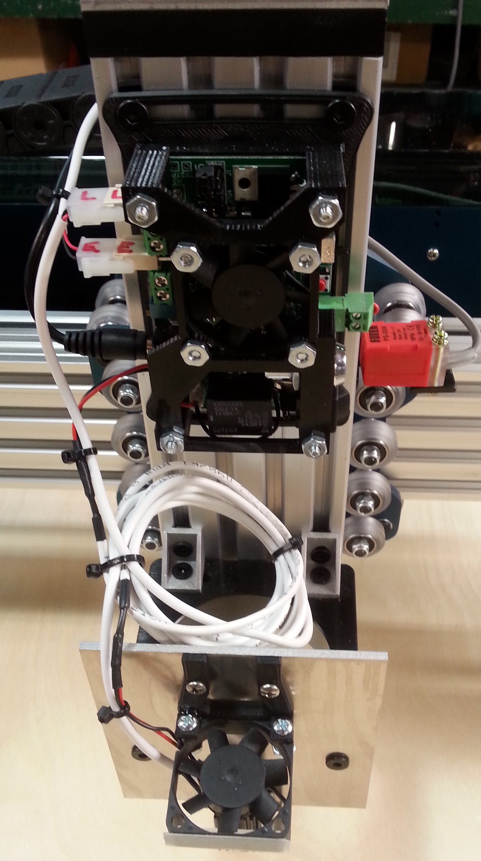

I usually just run the wire through the cable chain to the top of the z axis v-slot, along with the laser power cord. Jtech has a mounting adapter that allows you to mount the laser controller on the top of the v-slot. I mount the laser on a 3x3" or so 1/8" aluminum plate with 2 holes drilled so it mounts in place of the router hold down on the front of the router mount. The plate acts as a heat sink for the laser and keeps it cool. Use a little heatsink grease between the laser and the aluminum plate. Note the fan isn’t really needed for cooling, but it blows away the smoke.

I think I’ll put both the wires for the spindle and the laser in the M 1 slots for the PWM. I’ll leave both wires in there all the time. The laser wire will have a plug just outside the enclosure that I can unplug to remove the laser from the machine. The laser module and laser are mounted on a piece of sheet metal that I hook to the front of the spindle. It is kind of a rube goldberg attachment until I come up with something better ( or Brandon does).

My dust boot mounts to the spindle holder as does the laser set up so The dust boot is off when I use the laser. I would post pictures but I’m sure everyone would laugh at what I did. It works and was quick and easy but is anything but elegant. At some point if I see a good design I will do it and replace my Rube Goldberg or I come up with something myself. I am using the 400 w spindle and the 2.8 w laser.

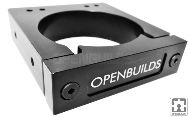

@Brandon_Satterfield I bought the SMW3D Ox kit with the 400W spindle but I didn’t see any nice bracket with 2 screw hole for attaching things like @Darrell_n 's picture is showing. The bracket I bought from you only had one screw and clamped down. I would like to do this setup with the 2.8W laser but the spindle bracket is where I’m stuck right now. Do you have a link to the bracket that can do this type of setup?
@Michael_Forte Mike, that’s an Openbuilds Router Mount for a Dewalt DWP611 or Bosch Colt router. Personally, I would much rather use a standard air cooled AC router that has 1.25 Hp (950W), easy parts availability, and much higher quality than one of those 1/2 Hp chinese water cooled spindles.
