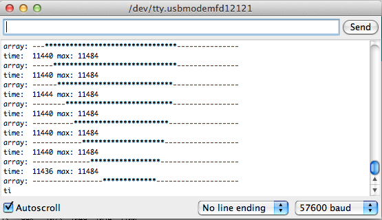

Not yet done optimizing - but some numbers (also, I think i may throw this into the library):
There’s four runs. There’s Perlin - which is the fixed point adaptation of Perlin’s improved/simplex noise that @Kasper_Kamperman linked to above.
There’s inoise16w12 - which is a 16bit version of the perlin function (no 32 bit math at all :slight_smile: using a 12-bit fade instead of 16-bit (like the original prelin).
Then there’s inoise16w16 - which is the 16bit version, but using 16bit fades instead of 12bit.
Finally, there’s inoise8 - which is an 8bit version, with no 16 bit math operations.
Perlin: 4.444px/ms
inoise16w12: 4.975px/ms (10% faster)
inoise16w16: 5.347px/ms (20% faster)
inoise8: 6.329px/ms (42% faster)
Video and code coming soon :slight_smile:
(oh, above numbers are on an arduino nano, running at 16Mhz)
I’m sorry, I seem to have gotten the above numbers wrong. (What’s that noise you ask? Er, um, don’t worry about it, we’re just strangling the life out of gcc in the background. We’ll set it on fire and walk away soon enough).
perlin: 4,444px/s
inoise16w16: 14,925px/s (335% faster)
inoise8: 28,571px/s (642% faster)
Or, to put another way, it takes only 35ms to update a thousand pixels w/inoise8 vs. 225ms for a thousand pixels with Ken Perlin’s fixed point implementation. (Your 50 pixels above would take about 1.75ms).
