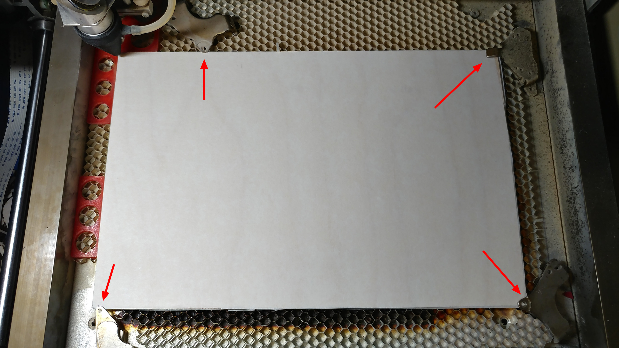

Most ply will do that over time. Try clamping the sheet down. I hold mine down with magnets in each corner.
I scavenge hard drive magnets and use them in the corners of the piece:
