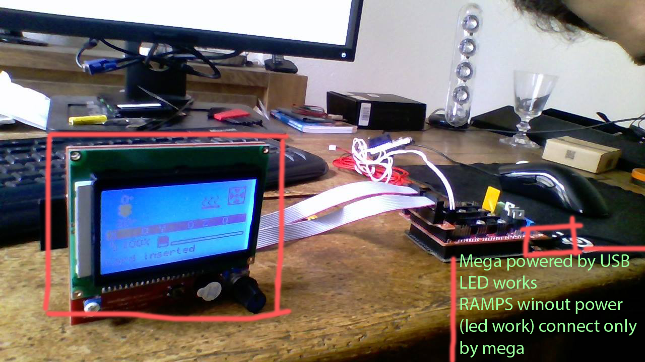

I have a problem in my ramps 1.4
My ramps board dont work when I plug in with the power supply, but it works when I plug in with USB at the mega!
someone can help me??
I will also send some pictures to better view

@Nathan_Walkner the picture that the LCD is turned off is power by ATX
and When is turned on is power by usb

the problem is solved, I changed the voltage regulator and is now working well!!
