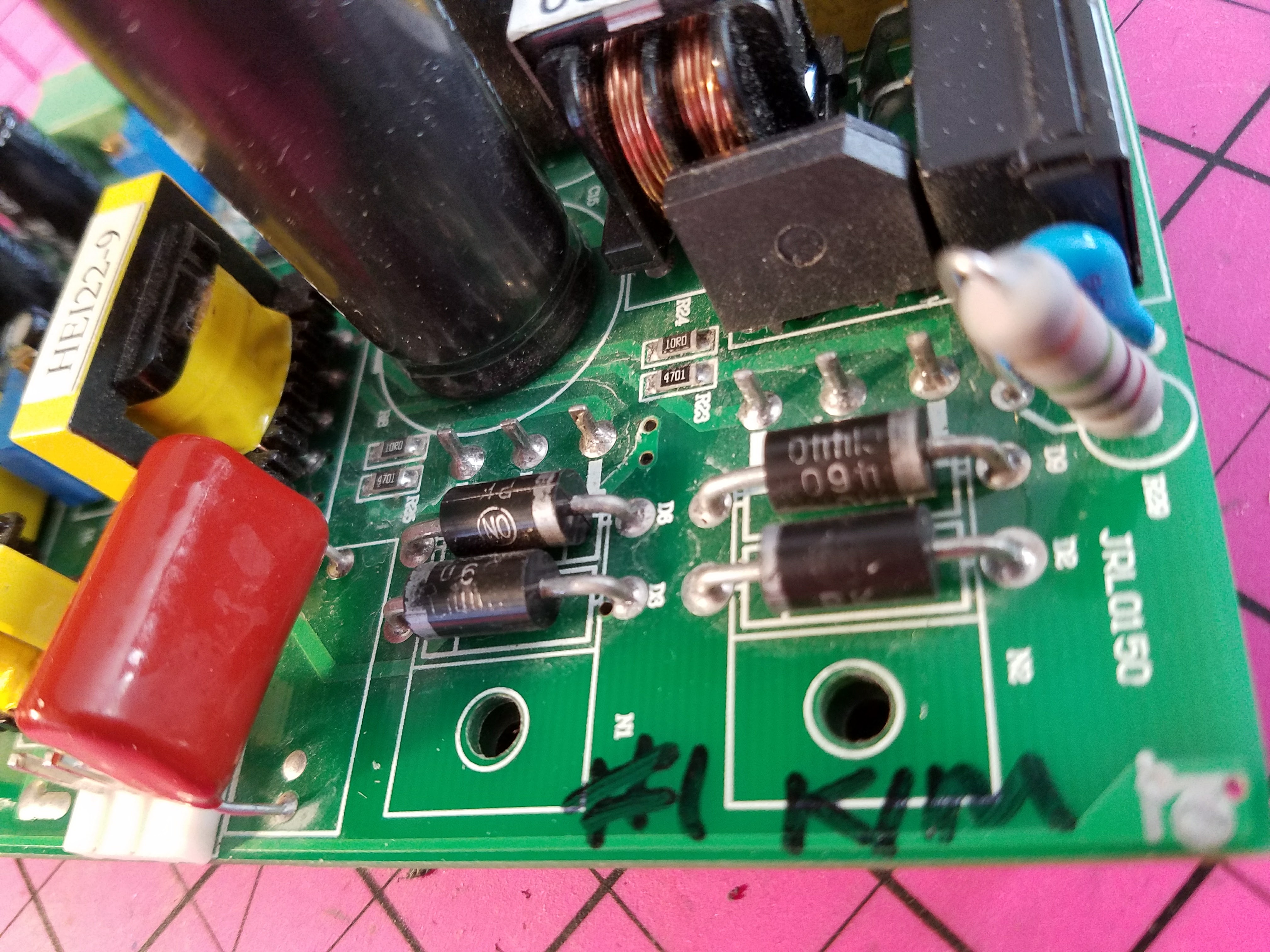

These rectifiers; where are they located?? I can’t find them.

In the attached picture:
The bridge rectifier is at the top right. It is a black rectangular device with a angle removed from it upper right corner. It will have + and - molded in its surface somewhere near the leads.
The Diode rectifiers are the 4 tubular black devices with silver lettering and a silver band around one end.
