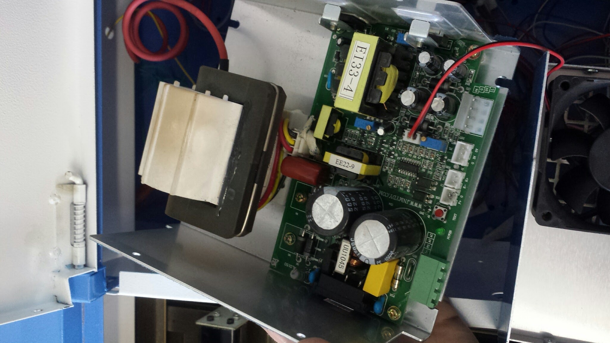

Please post picture of your supply.
Here is the power supply. What test button do you mean? No response on the front panel or in laserweb. Or on this test button on the power supply.

Here is the inside of the power supply. The little fuse in the corner is not broken. I checked it with a multimeter.

In your photo you have a green AC power connector at the bottom of the page.
Next above that is the green power LED. That LED will will be lit when the internal +12V portion of the power supply is working. That’s a good sign. Likely that means the other low voltages (+5V and +24V) are also working.
Next above that is the red push button TEST push button. It is incorrectly labeled “TEXT”. When your machine is put back together and the AC is powered up, pressing the TEST/TEXT switch will cause the laser to fire. However, if the Intensity input (normally a dial) is set too low, it won’t fire. And you said you have no pot (instead a digital design). So, for the time being, this is a dead end.
BUT THIS MIGHT BE THE PROBLEM:
Next above that is a white connector labeled [P+ G]. And in the photo it looks kinda funny? Looks black as if something might have arced, and the pins looks mashed together. Especially compared to the next connector which looks normal.
Can you take a better photo? That connector is part of the “protection” circuit, and would certainly give the symptom you’ve described if the connect is damage, or if something zapped the input. In the basic machine a front panel “Laser Switch” (push on/push off) will enable or diable the laser opertaion. And a front panel “Test Switch” (momentary on) will cause the laser to fire as you press it…but only if the “Laser Switch” is on.

@Andreas_Benestad if the “test” button (red) down on the PCB does not fire the laser its likely you have a bad supply, provided that you have AC power on the left connector.
Is the green power LED on, located on the power supply (next to the test button) when you power up the machine?

…That PCB test button bypasses all the other protection mechanisms so it it does not fire with that test button the supply is fundamentally broken … some how.

Yeah the green light (power) is on when I turn it on.
I have re-soldered the connection between P+ and G. Still no difference.
Seems to be the Flyback transformer. But is there a way to double check this? Would hate to order a new flyback only to realise I should have gotten a whole new PSU…

Is it safe to assume that since everything else works/moves correctly, and the only problem is no laser fire, that the issue is the flyback? And that the rest of the PSU is working normally? Apart from the tube being bad, can there be any other explanation to this?
Debating whether I should just order a new flyback, or an entire new PSU.
@Andreas_Benestad I get that question allot. Most power supplies that I have worked with have your exact symptoms. Only in one case has a flyback repair attempted and in that case it worked. Most people just buy a new one any my source of information ends…
The typical parts that fail and the symptoms are:
…Rectifier: blows the fuse and the part is charred
…HV diodes or MOSFET: blows the fuse and/or charred parts.
…Flyback: your symptoms
In your case my intuition suggests that its the flyback but I cannot unequivocally prove that.
This is part of the reason I am collecting bad ones. So that I can find out why they fail and make better recommendations on replacement/repair and perhaps improve the design or how we use them to the point they last longer.
If you are not budget and time constrained try the flyback first but be prepared to get a full supply if that does not work.
If you are time constrained get a new supply.
If you are budget and time constrained flip a coin and hope for the best…
