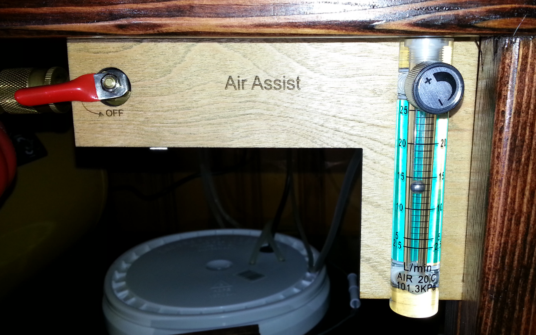

As that excellent linked post above said, you really don’t need a large flow rate for the standard “air assist” heads most of us have. I have a flow gauge on mine and I’m really only running 7-10 L/min for most things. It’s enough to keep the lens/cut area clear and to mitigate against flame ups.
@Nedman what flow gauge do you use?.
@donkjr It’s one I got off Banggood but it looks like they aren’t selling that one anymore.
@donkjr I found it on amazon https://www.amazon.com/LZQ-5-Flowmeter-2-5-25-Meter-Oxygen/dp/B01CKR39XA/
I need if for no other reason that it looks cool :)!
It’s also really cool if you light them with an LED. :slight_smile:
#K40AirAssist
OK… that did it one is now going on order! Maybe one for my CNC mill also :)…
