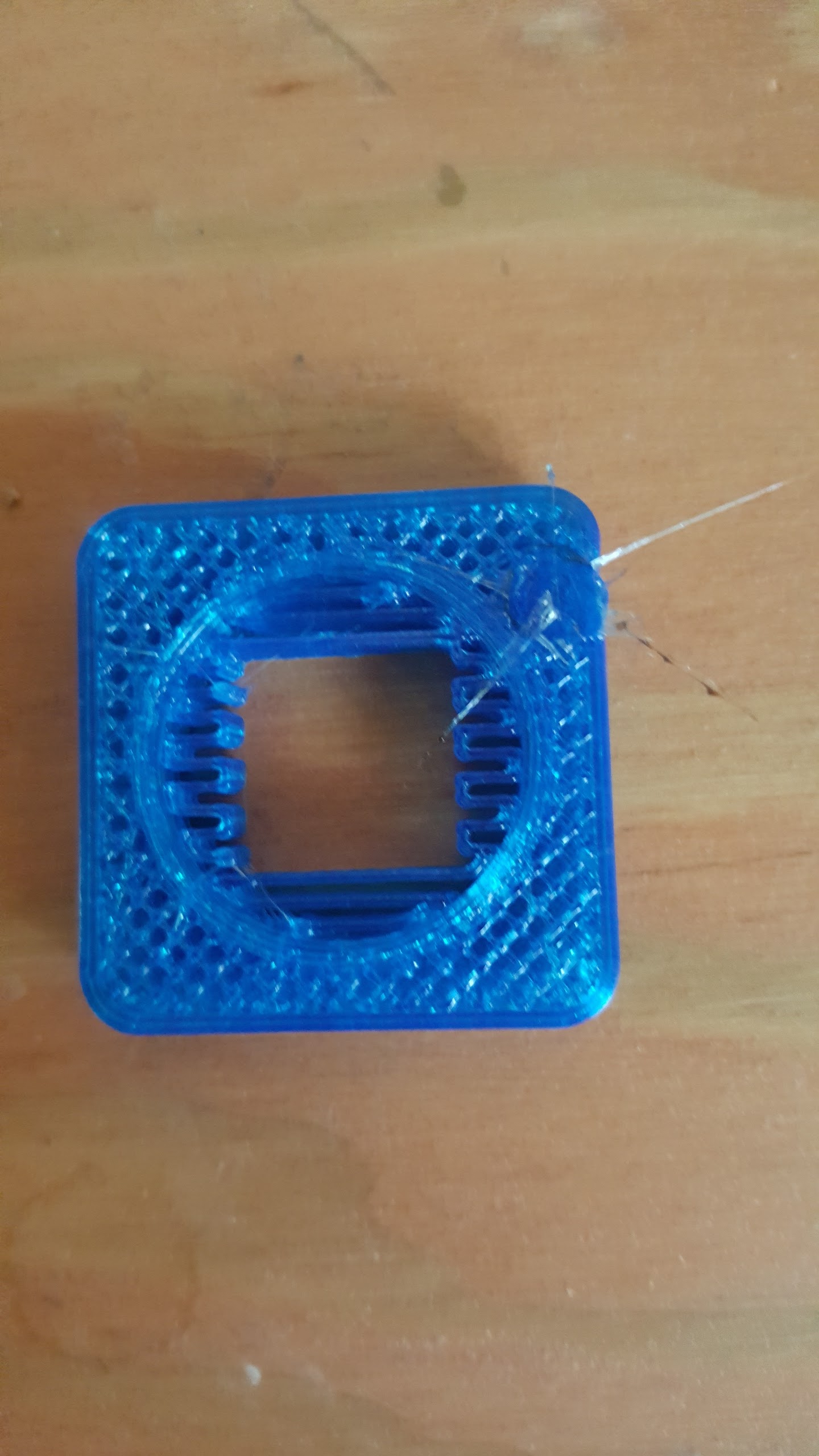

I have a question about my kossel mini printer,
I have a question about my kossel mini printer, it is the weirdest thing I’ve ever seen. Mid print it decided to drop in the Z about 3 to 4 mm and bury itself. This happened twice in different locations on the part. I am using simplify3d and the printer was working fine. I checked the part for flipped normals and to see if it was manifold which all checked out. I’m wondering if it’s a ramps heat issue or something because the machine almost seems to twitch as it’s doing it. Any ideas?
