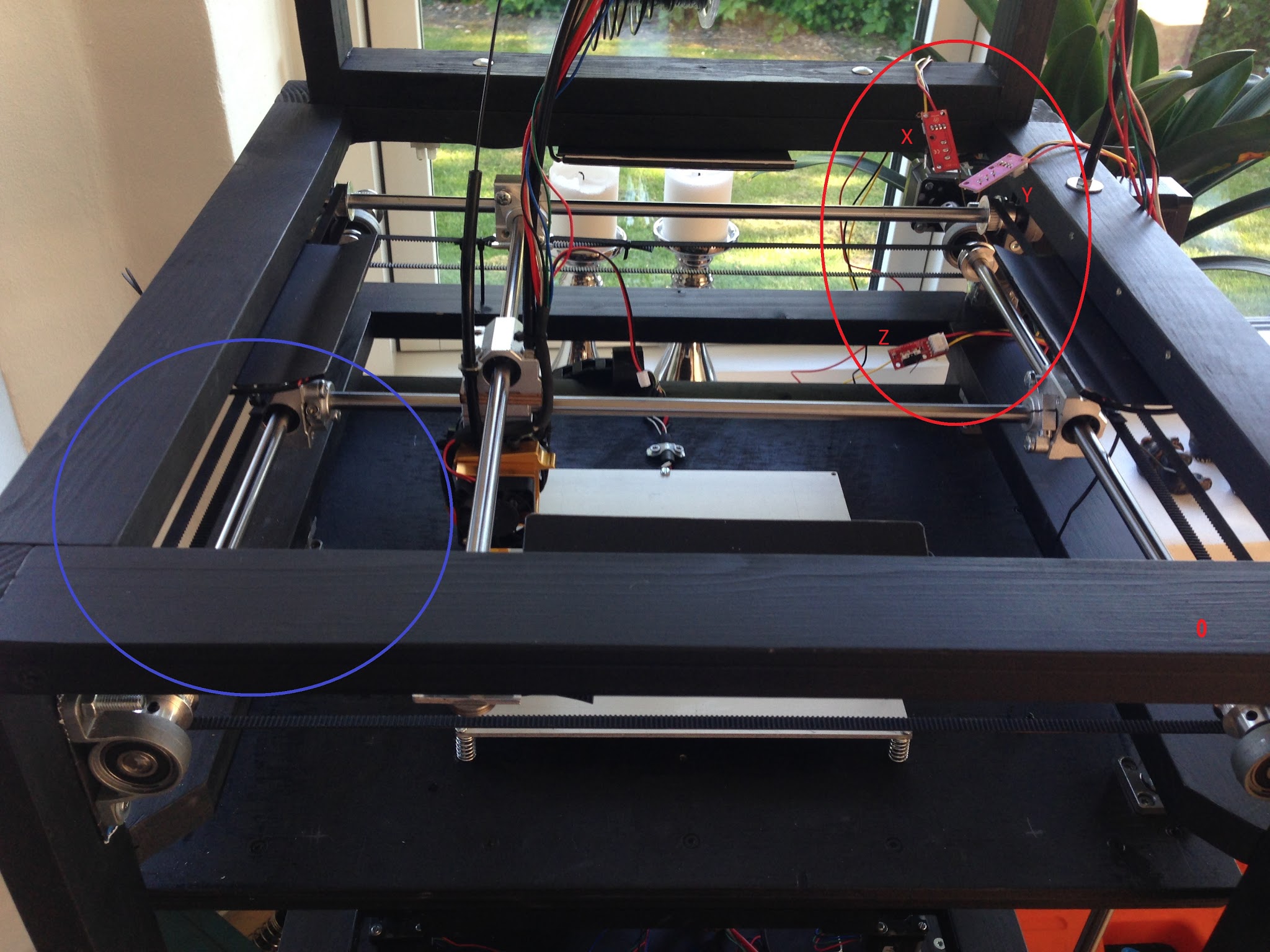

I have a question about placing the endstops.
I think about placing x and y endstop in the red cirkel (picture). but if i do that would my end stop be max instead of min? or should i place them in the green cirkel.
At the z axis endstop should i place that in the red cirkel to so my endstop will be in first layer hight?
is that a max endstop to then?

I have put my endstops (in a smaller but similar printer) on the frame so one side carriage will press the endstop lever when is close enough.

would my endstops be max endstops?
You can decide on which side (max or min) you want to put and endstop as far as you configure it consistently in your firmware (that includes the right home direction for each axis).

You’re going to want to put your X and Y endstops in the minimum position, the front left of the printer (your blue circle). The Z-endstop should be at the top of the printer, so the bed stops just before it hits the nozzle.
erik scott if i do that is all the endsstops min?
Yes. They should all be min endstops. You can add max endstops too, but you need the min ones for sure.
is it not possible only to use max endstops and place them at the red cirkel?
Not sure, but I wouldn’t recommend it.
@E_Wadsager unless you use negative coordinates on both axis the max should happen on two corners instead of one
i think im just gonna place them at blue cirkel then
You can easily have them at the red circle, but y+ will be coming towards you, and x+ will be heading left as you stand at the front of the printer. I ran a printer like this for a while.
Is it not possible just to have max endstops and only home to max in marlin? I think that’s what the printrbot simple does for its Y-axis (the only printer that I have really worked with), and it should be just as easy for all three axes
I placed them in the red circle and turned the motor connectors around so:
x +: going left.
y + : going towards you.
z +: going down.
@E_Wadsager , instead of using them as min endstops, set the Marlin homing direction to MAX on your X and Y axes, and plug the endstops into the MAX header on your controller board
