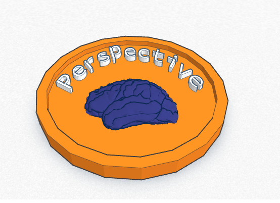

Is there a way to have a faster print speed for parts of a print and to slow down when it comes to fine details?
I am printing the image below and would love to do the base quickly and the letters slowly. Any advice?
Right now I am using Cura 14.12. Maybe there is a more advanced slicer that can do this?
Prusa’s version on Slic3r has adjustable layer heights this may work … IE. .4mm layers on bottom then .2 at the top.
If possible, I’d do 2 separate STLs, one for the letters, one for the rest. Print the non-letter part at high speed. Do not turn off bed heating. Slice the letter STL with the appropiate z-offset and speed. Slic3r can do z-offsets, but its auto-centering of objects may put things off. Anyway, you could, say, add a “register” by printing the coin brim AND letters in the letter stl, and a brim-less coin with brain, and therefore it’d be centered.
In Simplify3D, you can make processes that act on layer height regions. It would be simple to make one process for the lower layers, and another for the upper, with completely different print settings as you see fit.
That is exactly what I need. Now I just need a few more reasons to invest the $$ :slight_smile:
Check out Slice3r Prusa Edition. It allows “Mods” which are solid areas imported into your model where you can modify the settings (including speed) in just that area. As a separate function, it also allows layer editing to control layer height in multiple Z areas as needed. For your example a “Mod” would probably just be an extents cube with its base at the Z height where your lettering starts.
