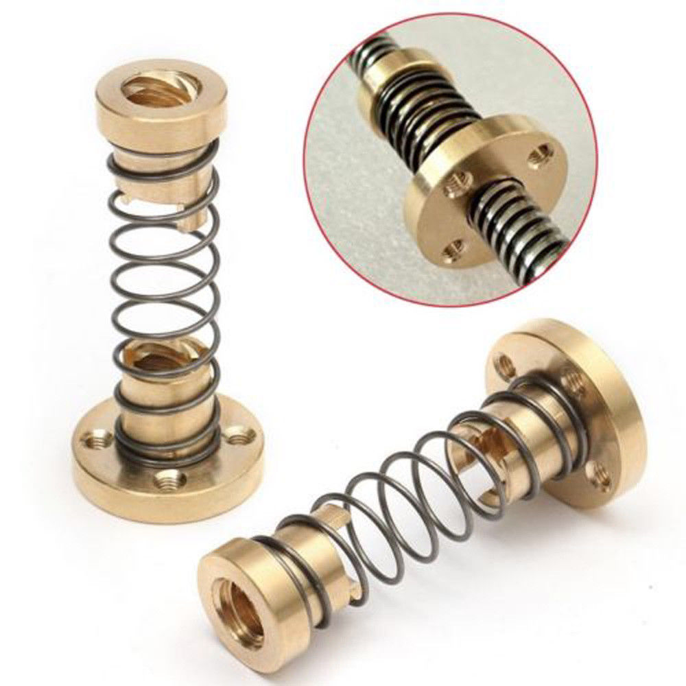

Do note, the brass nut outer flange (where the screw holes are) is slightly smaller compared to the POM nut the Prusa i3 (MK2 and MK3) uses. but otherwise not to different. Regarding backlash for the brass nut, you can get spring loaded anti backlash versions like attached image.
Yeah i just got the regular ones. Not the ones with springs
