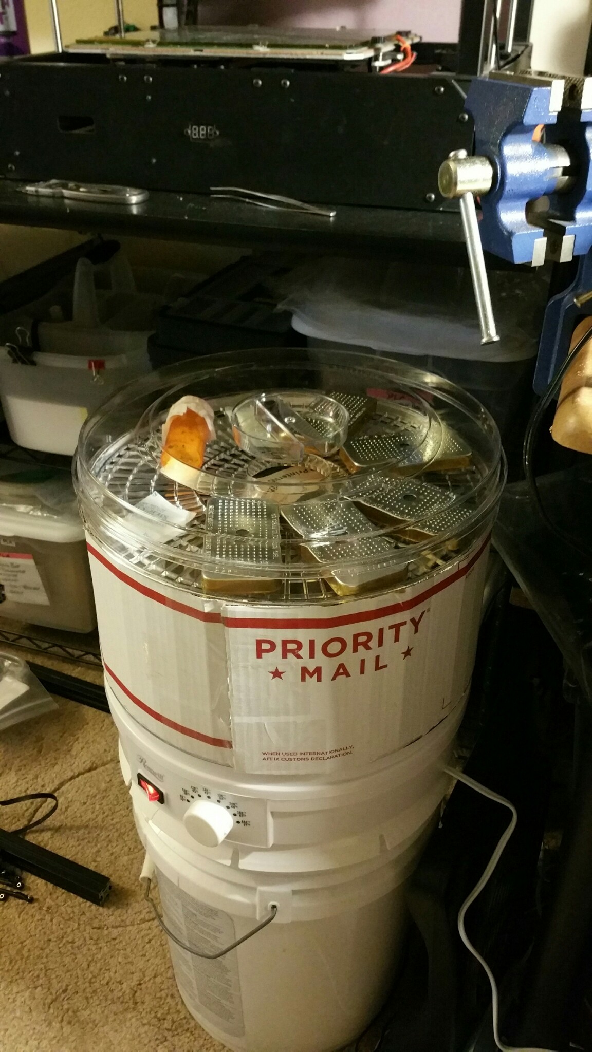

I bought a food dehydrator, added a cardboard spacer to fit two spools, and another tray on top for desiccant bags (they need to be dryer than what you’re trying to keep dry). Seems to work great, though I haven’t printed anything recently.

I also use a food dryer, but dry my dessicant in the microwave, which takes around 3 minutes for a small bowl. Never, ever touch hot dessicant out of a microwave, it will give you horrble nurns
