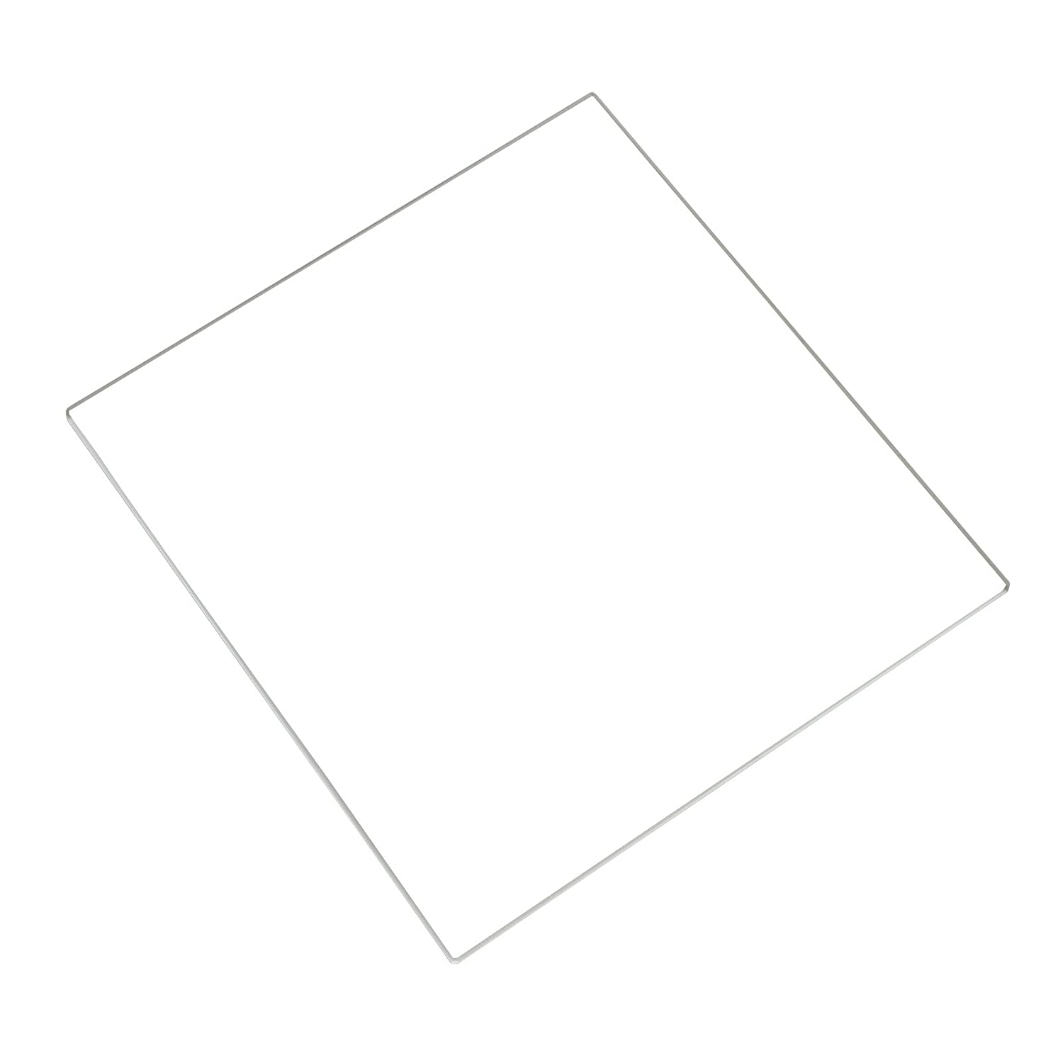

I highly recommend going with hairspray on glass… it will make your life a lot easier.
clean the glass well with alcohol before applying a thin coat of hairspray. Use binder clips to hold the glass to your existing bed.
