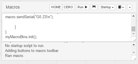

I already did a macro that did this with 2 different buttons, but I would like chilippeper to do this by default
The macro is quite simple I leave it then if someone else wants to use it.

var btnGrp = $('<div class="btn-group pull-right mymacrobtns" style="margin-right:6px;"></div>');
var btn1 = $('<button type="button" class="btn btn-xs btn-default mymacro-btn1">HOME</button>');
btn1.click(this.onBtn1Click.bind(this));
var btn2 = $('<button type="button" class="btn btn-xs btn-default mymacro-btn2">CERO</button>');
btn2.click(this.onBtn2Click.bind(this));
btnGrp.append(btn1);
btnGrp.append(btn2);
$('#com-chilipeppr-widget-macro .panel-heading').append(btnGrp);
