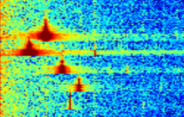

The easiest solution I found for audio processing is with a Teensy and an electret mic. I started from this example :
It’s literally just a Teensy and a mic. Doesn’t get easier than that.
There is some tuning required in software of course, you have to be able to adapt the function to your needs, but it’s possible. You don’t have to understand what the Fourier does, just how to manipulate its output.
Since you are using WS2812B leds, you won’t be able to sample sound during FastLED.show(). I strongly suggest you look into parallel output to reduce your show() time. Or use a 4-wire protocol.
As for club decibels… I found the louder it gets, the murkier each frequency becomes.
