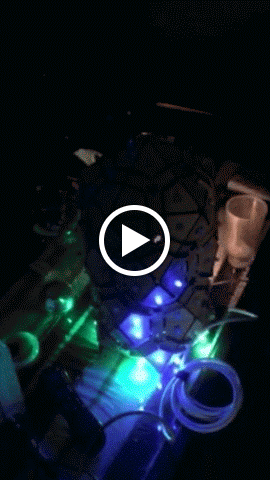

I have an ongoing project that I just converted to use FastLED and the
I have an ongoing project that I just converted to use FastLED and the conversion was super simple (admittedly due to previously using my own wrapper layer around the Adafruit_WS2801 library). The video I attached is one of my units, but I have a bunch of different ones using the same underlying hardware.
The LEDs I’m using are the equivalent of https://www.adafruit.com/products/322 (but bought direct from a manufacturer), but I’ve seen a lot about the WS2801 led strands being outdated so I figured this is a good forum to ask about that on.
Are there better options out there that have similar characteristics to these WS2801 LED strands? My main requirements for them are that they come in a package that is easily mountable on panels (ie these have little plastic tabs that will hold them in place on an appropriately sized hole), that they be fairly rugged and weather proof (ie they may get rained on once installed), and preferably that I can order strands with differing wire lengths between the pixels (the ones in this video are 10cm separation, but I have others using 20cm separation). What else is out there, and FastLED supported?
