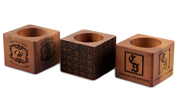

Purchasing wooden napkin rings and engraving names or logos is one thought.

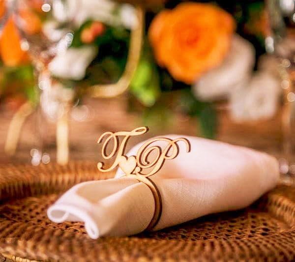

Cutting rings from 3mm ply with the laser would likely leave some burnt or charred edges that would transfer the soot to the linen napkins (either when inserted or removed). So the wood would likely need to be finished/sealed.
The diameter of a typical napkin ring is pretty small, so the outside “arc” is probably not flat enough to engrave directly. So you’d likely need a rotary attachment unit for your laser cutter. So that’s another accessory and cost to consider.
@Nate_Caine Nate is on point. Doable, but no particularly the best solution. Without a rotary attachment you wouldn’t be able to engrave more than three or four letter, depending on the size.
