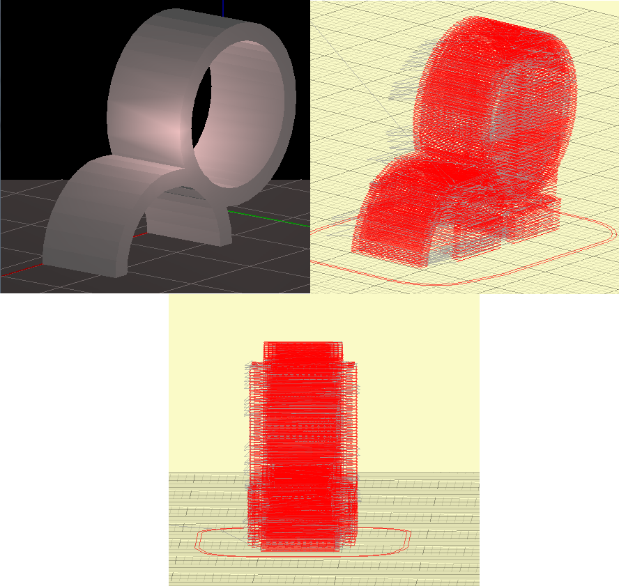

I have been experimenting with support material in Slic3r 1.0.1.
I have been experimenting with support material in Slic3r 1.0.1. This particular shape is creating difficulties.
I have had success using default settings and interface layers = 1 on simpler shapes. The support inside the ring is difficult to remove without cracking the ring. The support under the ring is too difficult to remove.
Any thoughts on how to improve the supports without generating them in a different program?

@Josh_Ajima , like @Mike_Miller said, this piece is just to try support. I started with an inverted demisphere and then with just the lower demiring. This is level 3. I think level 4 might include an inverted cone as well.

Possible to reduce extrusion width for support material to a minimum thus making removal easier. Only tried this once but it did seem worth further experimentation.
@Josh_Ajima , I’ll give that a try but the support already releases cleanly under the arch. The problem seems to be when the edges of the support run parallel to a permanent surface.
In the picture, you can see that the leg of the arch under the ring is encompassed by support which is wider than the structure as a whole. I suspect that improving this would mean either adapting the shape for easier printing or changing the shape of the support. Perhaps I should give slic3r 1.1 a try.
