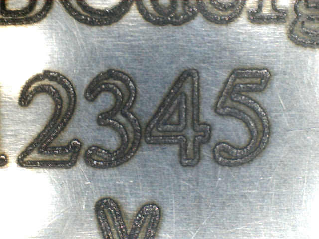

Very interesting this last utube of Sebastin’s is exactly what I’m seeing with engraving under the microscope as. I’ll see if I can post a picture. Martin, the only difference I can see is I’m using a different aftermarket lens a ZnSe- F50.8 mm.
http://www.lightobject.com/Improved-18mm-ZnSe-Focus-lens-F508mm-P206.aspx
Martin and all, here is a microscopic view of the the lettering with CRC used. It’s about 3.8mm tall. After RDworks lab 100’s post It I get time today I’ll try it without the coating.
I’ll also revisit the power settings and feed rate.
