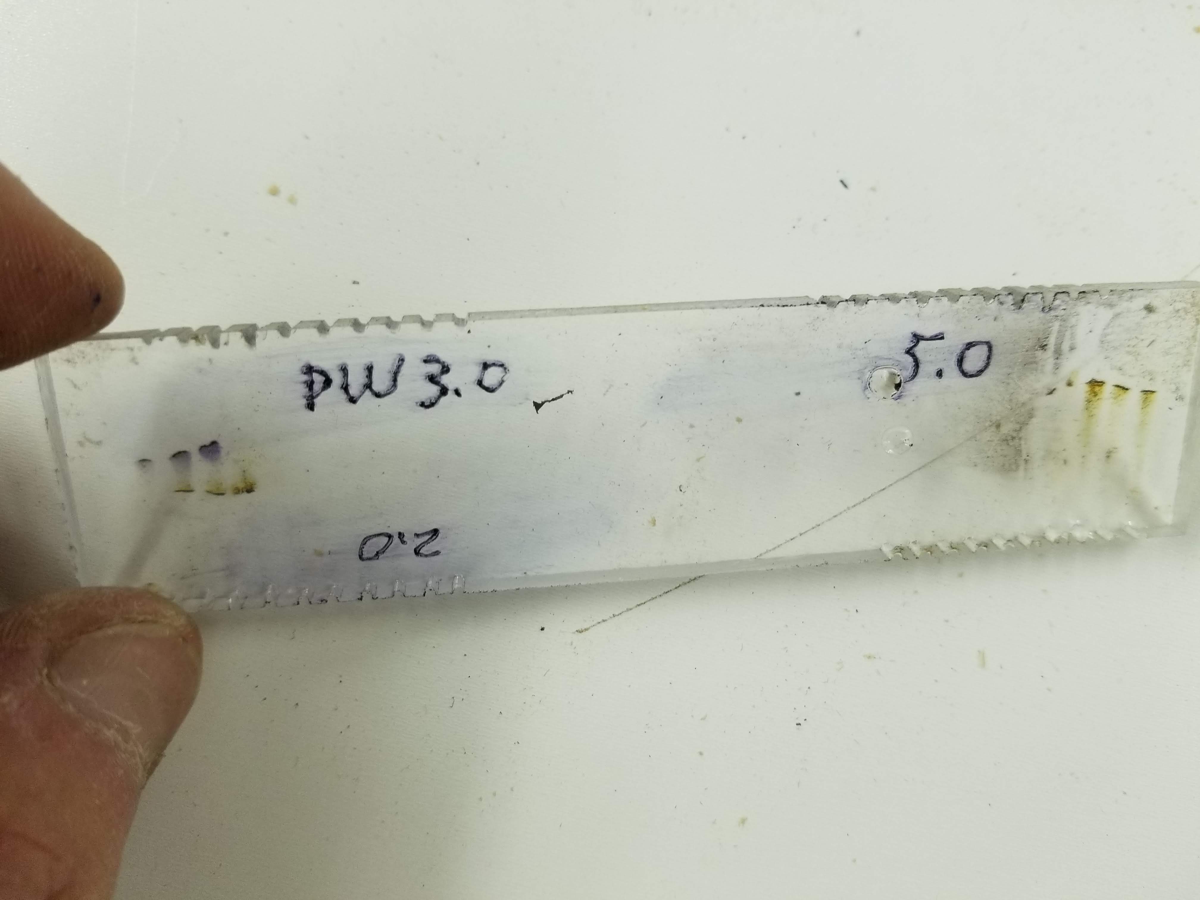

Today I decided to do a power test by cutting across the edge of a piece of .22" acrylic to see how deep it cuts.
The acrylic is set on edge in the cutting area, its edge at the correct focal point.
I designed a test in LightBurn that cuts perpendicular to the sample. It cuts 10x and for each cut the % of power is increased by 10%. These vertical cuts are .7" long and .125 apart. The speed is .5 ips.

In the photo below you see the 10 cuts.
They are about .125 apart but you will notice that they are all the same depth. Actually in some cases earlier ones are deeper than later ones. Huh!
They are not very deep but that could be a lens or alignment problem.
