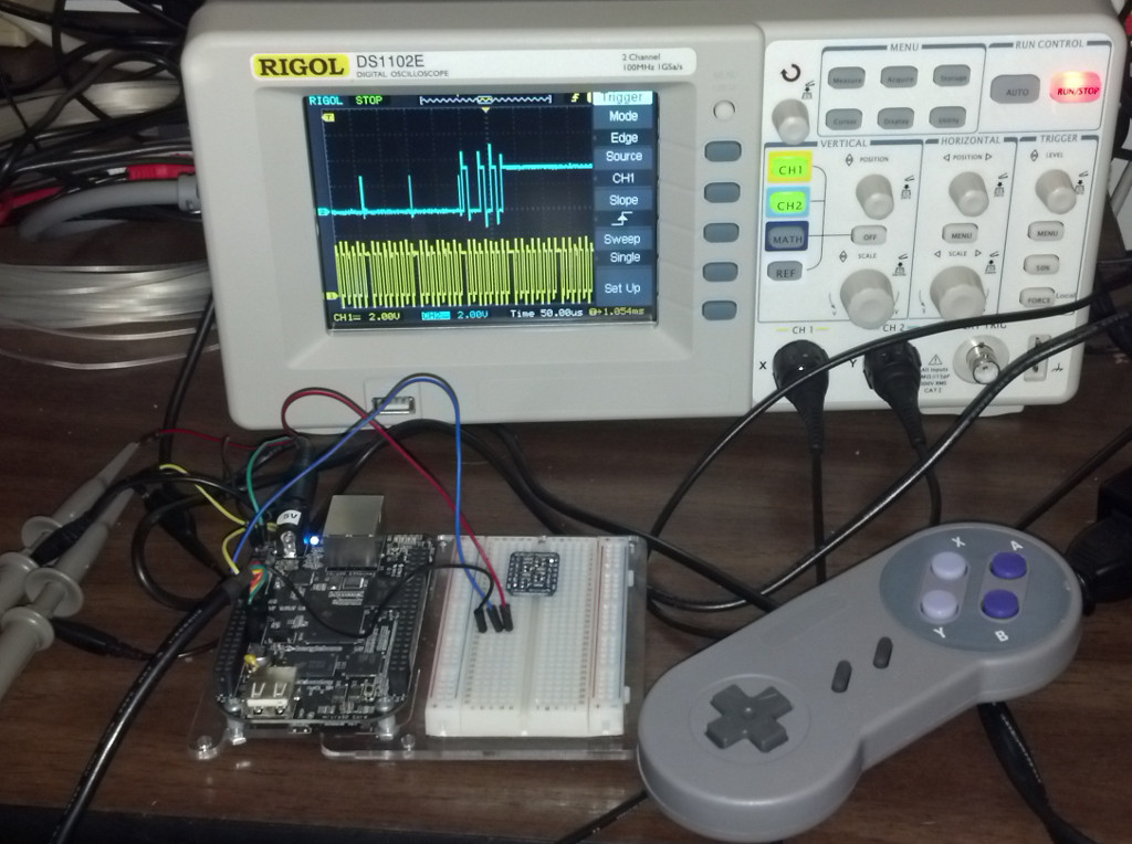

Looking at my scope’s output, I can see that the signal looks good (even at the full 48MHz clock speed). I’ve found that if you slam the MCSPI_CH0STAT by polling it over and over, you will receive a bus error. But, if you poll only 500 or 1000 times before timing out, it works out better. Also, you can probably busy-wait a bit more between checks. You’ll want to usleep() immediately prior to sending your message(s) to ensure that you’re sending your SPI data from userspace at the start of your current timeslice. You could use sched_setscheduler() to boost the priority of your SPI comm thread to real-time priority, but I didn’t see the benefit in this. If you need real-time guarantees, you can always use the PRU to talk to the SPI registers.
