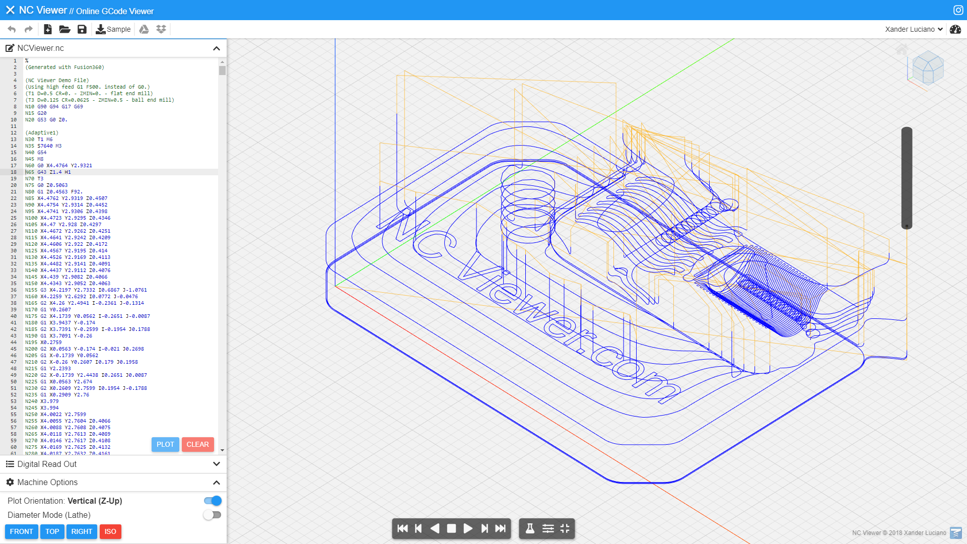

@Michael_Memeteau The analyzer does not like my simplistic gcode. I think i am missing some instructions that it might be looking for. I think that it is looking for a properly formatted print file with layer info and the like.
These two seem to display the tracks https://nraynaud.github.io/webgcode/
