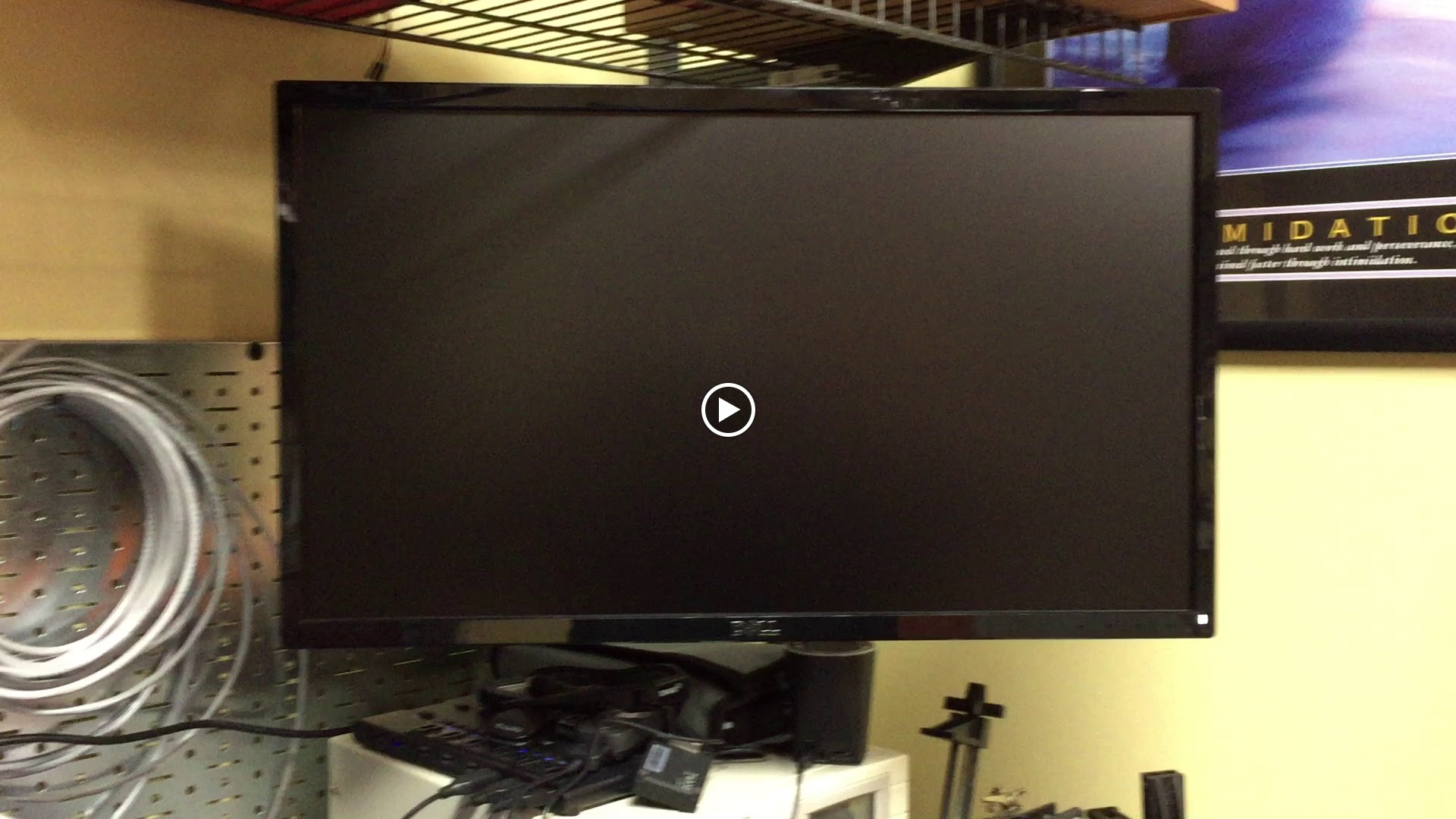

I have chilipeppr and the serial port server running on a raspberry pi 3. Raspbian boots directly to chromium in kiosk mode pretty quickly, and even the default TinyG workspace runs acceptably at 1080p. My goal over the next few weeks is to build out a workspace optimized for the pi3 performance limitations. I will need to make a few component changes also, it seems as though the shadow in the 3D view is problematic, and a few items can be tweaked for better touch input.
The WebGL on Raspi3 is a bit rough and flickery, but it looks like it’s working.
