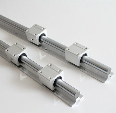

and the linear rails I bought on ebay, similar to this
I found a US supplier.
