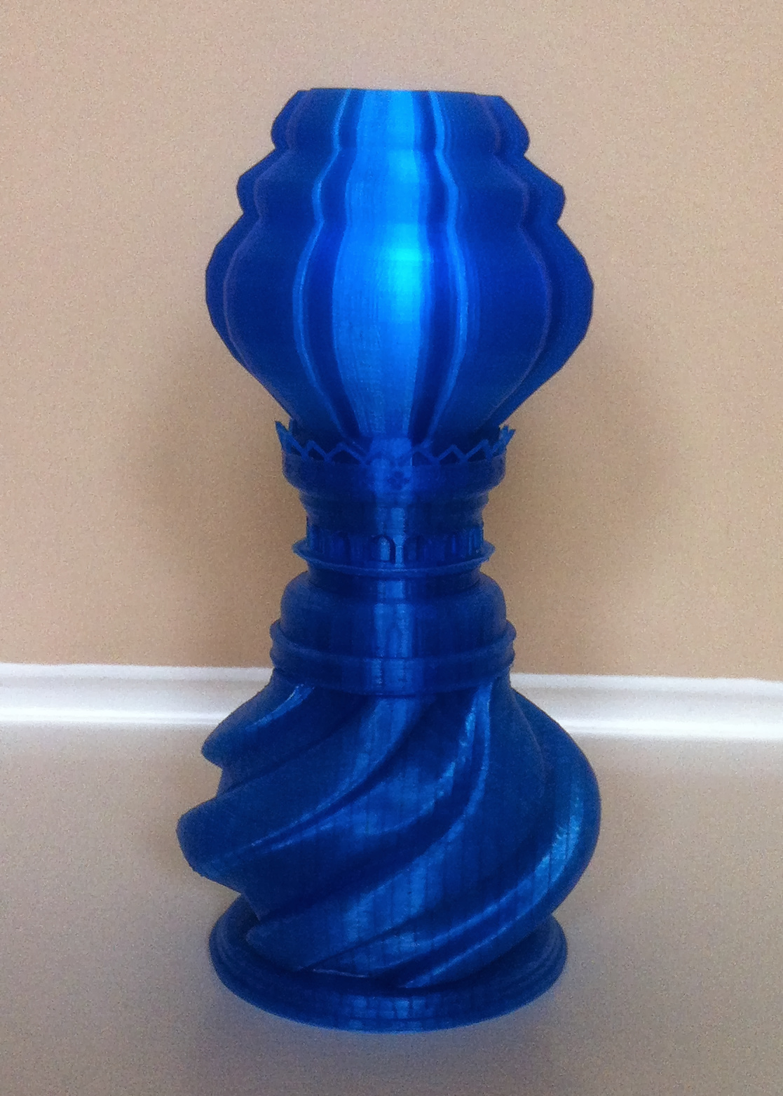

I have designed a 3D model of a Victorian style hurricane lamp.
I have designed a 3D model of a Victorian style hurricane lamp. It holds a battery-powered tea light.
It comes in a number of pieces and screws together. You can have it either tall or short. This is part of an experiment for myself to show that Blender can be used for models that require some precision work. The threads were built in OpenSCAD using the library by aubenc, but the assembly and design was done in Blender alone,importing the threads when needed. This model was also designed to push my printers further regarding clarity and overhang. None of the pieces require support to print.
Here is the first test print all in blue, but I am printing it again in green and gold.
Feedback is much appreciated.

I used my Ordbot with blue 1.75 PLA. The Ordbot has a .35 nozzle. The base, the castle bit and the tea light holder were all sliced with .15 infill using a honeycomb fill pattern. The shade is a solid model which I printed with no infill and no top and bottom. The large swirly bit had a .1 infill with a rectilinear fill pattern. Temps for this PLA were 215 first layer and then 210 after and for the bed 55.
