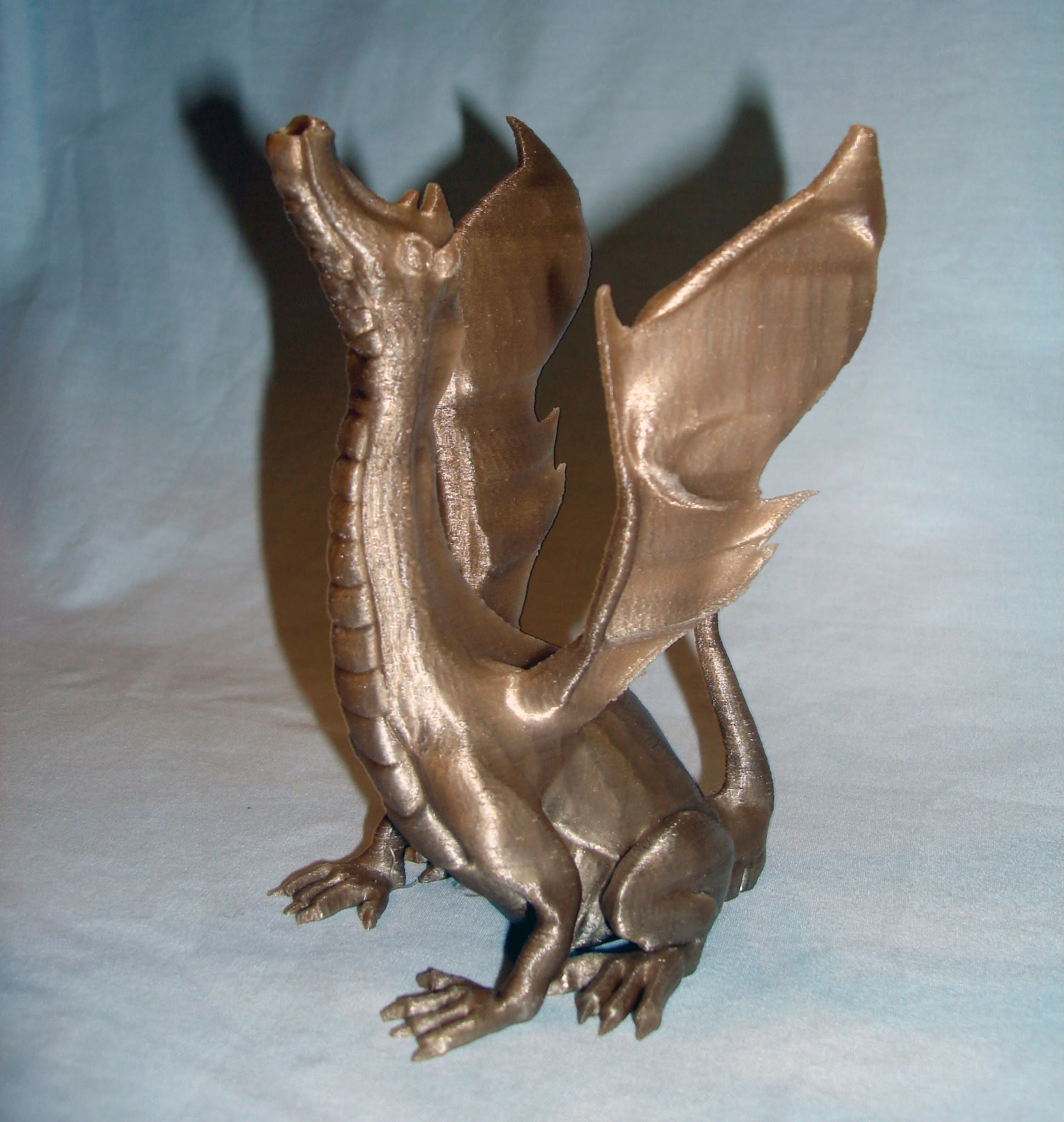

I have designed a dragon which prints without supports or need for assembly.
I have designed a dragon which prints without supports or need for assembly. Took a while to get the design right and battle with overhang as I didn’t want compromise shapes too much. Aggressive cooling required. The printer used is my Ordbot and the filament a gold 1.75 PLA printed on a heated bed using hairspray as a fixative.
Model can be found on Thingiverse: http://www.thingiverse.com/thing:246198

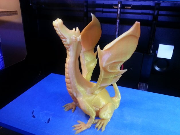

Awesome design. I printed one lastnight
THANK YOU
