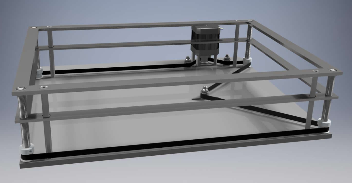

I use a 6mm base plate out of RESOPAL, shoulder bearings F605ZZ (5x14x5mm), stainless M8 threaded rodds (ends turned to 5mm) and a 6mm GT2 belt 1350mm long.
The bed itself will be a replaceable 1.6mm alu mesh fixed to the middle frame.
Yes, shoulder bearings on both ends. They are sandwiched between the top frame and the bottom plate.
I will try the threaded first, as I have them already. I don’t think they wear too quickly, as the Z-Axis is not used much, and still can replace them when needed.
IMO threaded rods are fine for Laser Z table. It’s not like a typical XYZ axis where they are constantly being run and when they do, it’s at low speeds.
I actually 3D printed some some short lead screws. I distorted them a bit by mis-scaling, but they worked better than expected. They definitely would fail quickly if used for a primary axis, but I think they will work fine for my z table. Especially when I print them on a hi-res SLA printer and utilize plastic safe lubricant.
I like the solid bottom plate over the one LO sells. Once lined up I think it will be more stable and less inclined to twist putting load on the motor and belt/pulley system.
I’m thinking of increasing the work size of LO one I have. If I do I think I will be plagiarizing your base design.
