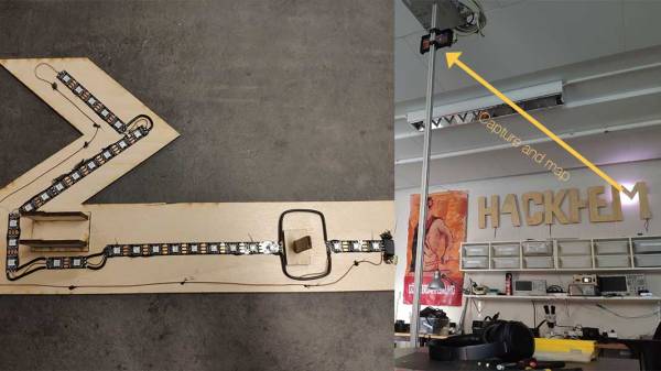

I don’t believe this is using FastLED, but here’s another project that used code to automate the mapping of their layout.
