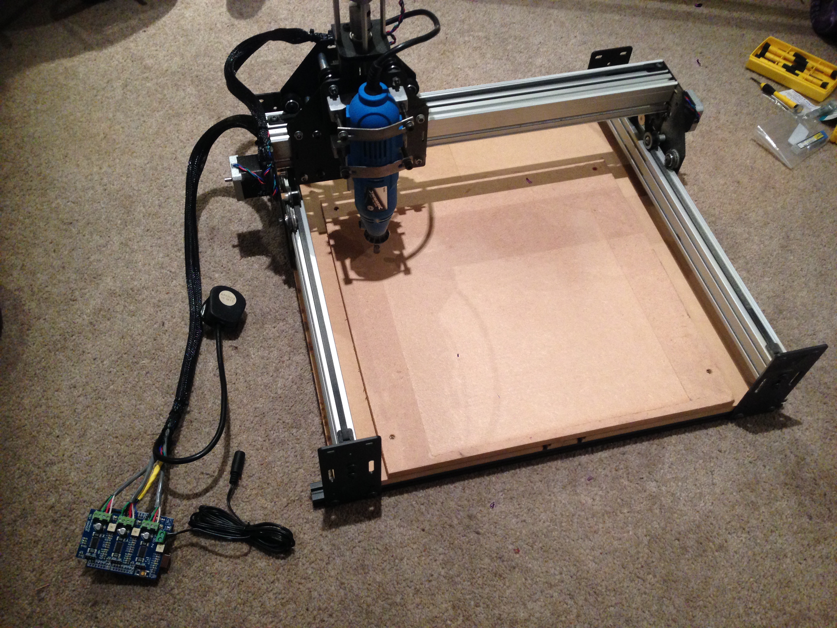

I have finished my wiring and now levelling the waste board with a 7.8mm
I have finished my wiring and now levelling the waste board with a 7.8mm bit. Ohh Christmas and my lovely family makes time on the project so precious!!
What size bit are you doing the leveling with? That looks like it will take a long time?
First run through 40mins! Using the stock spindle about 120 watts
Is there a faster way to get it truly flat?
If you have a larger collet, say 1/4", you could use a router bit that has a larger foot print. Not sure what 1/4" is in metric, but you get the idea.
A 1/4" is about 6mm.
Looks nice. Where is possible to buy that rails ?
It is the Shapeoko 2 kit. I got mine in the UK but they are based in the US.
