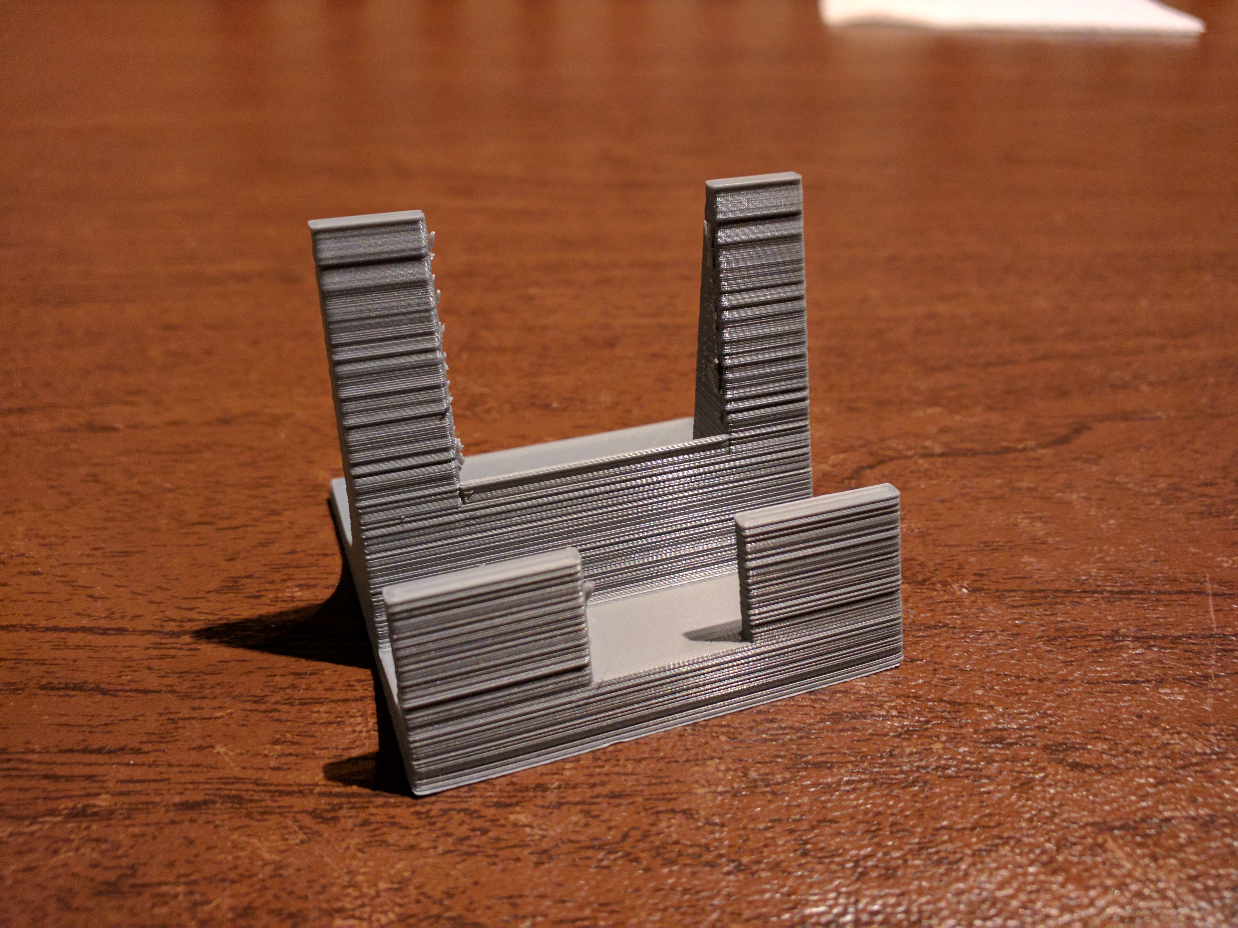

I have inconsistent layer registration. Is this likely caused by belts? Too tight? Too loose? Something else?
How is it in the other direction? Which axis are we looking at?
@Dennis_P It’s visible in both x and y. I actually just read your z height post and when I put in my stuff, my z heights are a little funny, so I might experiment with that
@Ryan_Fiske How did the bearings fit into the corner bearing holders. Were they loose? If so you might want to look into putting a layer or two of thin tape around the bearing before pressing it into the corner bearing holders. It acts like a shim to take up the gap and make for a tight fit.
Have you done PID tuning on your temps yet? If not take a look at this post as to why that’s a good idea.
https://plus.google.com/+EricLiensMind/posts/LuS8izruZUS
Lastly, Have you calibrated your extruder E-steps with actual testing. You look heavily over extruded.
http://reprap.org/wiki/Triffid_Hunter's_Calibration_Guide#E_steps
@Eclsnowman the bearings did have some slight play on install so I’ll definitely take a look into shimming those.
I have PID’d with a setpoint at my current temp.
I have calibrated my extruder steps by extruding 100mm, measuring actual and adjusting steps based on the difference which is pretty close to what the triffid doc tells you to do. Perhaps I’ll have to take a look at my extrusion multiplier, though if you’re saying it’s heavily over extruded, that might just really be a band-aid to a larger issue.
The more I look at that top surface, I might take back my heavily over extruded comment.
Try checking all the grub screws. And make sure the hotend seems well secured.
Do you have the shims between the pulleys and the bearing blocks. Without the thin shims, the pulleys tend to rub on the bearing face in the corner bearing blocks.
@Eclsnowman So I checked my hot end when I got home and it was loose! Not the nozzle, but the break to the heatsink. Tightened that up nice and snug. The next thing I did was I actually used that optimal layer height calculator and found out that 0.1 and 0.2 are NOT on a set step. I figured I’d give that a shot, figuring that maybe that might have something to do with it as well, and the print that I am doing right now looks much better! Which one it was, I am unsure of.
