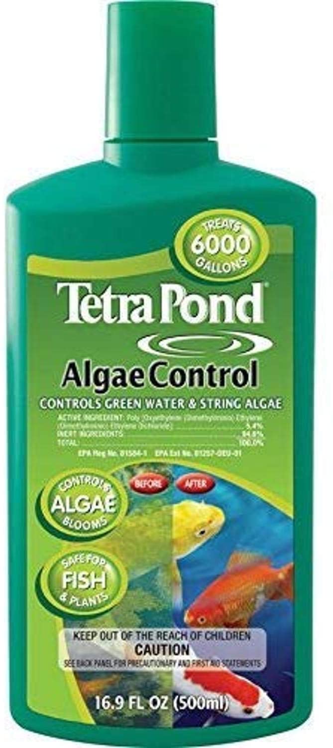

@donkjr hey quick question. I flushed the system and added 4 new gallons of distilled water. Then added the Algae Control. Doh, didn’t realize the stuff was going to pore out like water. I’m sure I now have 2 or 3 times what you guys suggested. Now i’m a little worried about me added frozen water bottles etc to chill the water. The warning label about skin contact with the Algae control got my attention. Should I flush the system again and be more careful with the chemical?
@Bill_Keeter @Nedman Ned what do you think your the chemist!
@Bill_Keeter Probably not a problem, but what algae control are you using so I can check the ingredients?
@Nedman Tetra Pond Algae Control. It’s the one Steve mentioned near the top of this post
@Nedman Here’s the amazon page. The 2nd photo shows everything on the back label.
Yeah the label doesn’t say what’s in it so I had to pull up the MSDS. It uses a polyquant antimicrobial called Polyquaternium WSCP. An occasional exposure to a dilute solution shouldn’t be an issue. I think even if you got some of the concentrated on your skin it would just irritate it if you left it on too long.
@Nedman okay, that’s what I was hoping. I use frozen water bottles to chill the tank. Which means me sticking my hand in the tank every once in a while. So the label saying any skin contact requires washing the area continually for 15 min had me thinking I would need to wear gloves and completely clean the bottles before adding them back to a freezer.
Nah, it’s not anywhere near that toxic. Just don’t bathe in it or drink it and you’ll be fine.
One note: the water conductivity we measured is at the concentration that was specified for the algeacide specified.
@donkjr Good point. I might just flush 2 gallons and add 2 more. Just to lower the concentration of the algae control.
