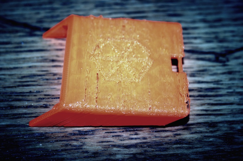

I have just bought a QIDI Tech 2 printer and I have successfully printed simple cubes, hollow tubes etc in both ABS and PLA but I am have a problem printing anything more complex. I have attached a couple of pics, these are in PLA, any idea what I should do?

No. Cameras do not naturally make the center of the picture brighter, with the edges of the picture fade to black like the pictures you posted. You have some sort of filter turned on in your camera. Makes it difficult to tell if that filament discoloration is natural, or a result of the stupid filter you’ve got turned on.
You don’t have anywhere near enough cooling to be printing PLA with overhangs like that. Point a box fan into your printer and find a nozzle blower mod to print and install.
@J_Seed He’s saying your photos are confusingly bad. Like you’re using Instagram or Snapchat with some sort of photo effect turned on. Makes it hard to identify the issue.

@J_Seed I don’t know what kind of cooler your printer has, but I can tell by looking at the prints that you don’t have enough cooling for PLA. Make sure the turbo cooler is pointing to the overhang side of the print. You may also be printing too hot. (Is Makerbot Desktop still using 230C for PLA? Drop it to 210C and see what changes.)
I also see some signs of inconsistent extrusion or intermittent jamming type behavior, which could be caused by a lot of different things. Extruding too hot, PTFE liner damaged, crappy filament, Makerbot Desktop settings being messed up, etc. Can’t do much to figure that out while you aren’t getting heat out of the print fast enough.
Fix the cooling/temp issue and come back with more print photos and we’ll

Looks like temperature to me.
Mmmmm, took apart the “turbo” fan and found that it wasn’t actually working, fouled.
Cleared the fouling and my next print was MUCH better.
