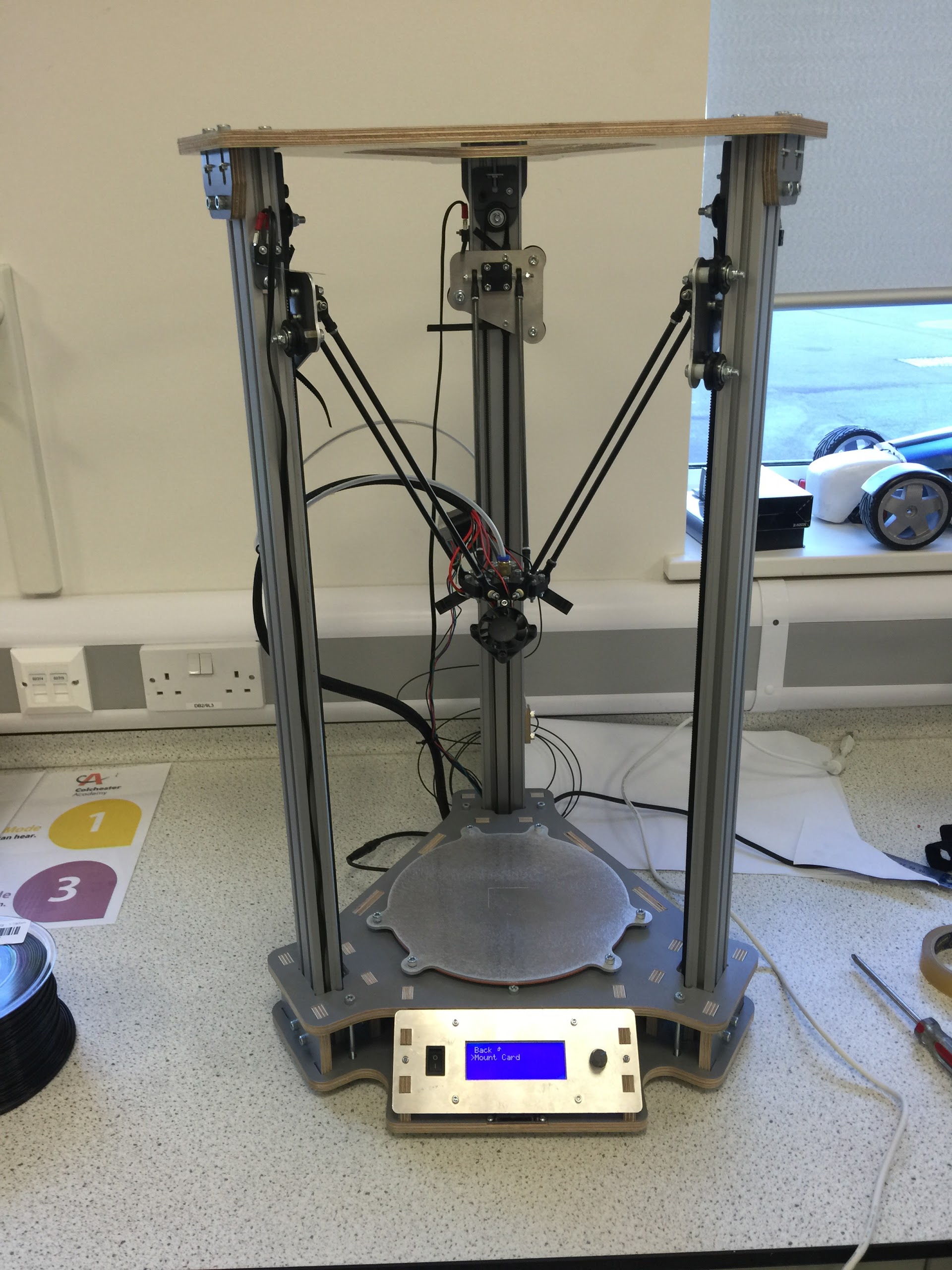

I have just built a 3D printer at work and am using cura as
I have just built a 3D printer at work and am using cura as the slicer. Today we managed to get the 3d printer to print the test piece using pla. But now am going to print something from solid works. My question is do I have to hollow out the model before I print, or will cura do this for me? If I created a cube how would I create the structure in the model to print it? Hope this makes sense. Many kind regards

I am still amazed that type of 3D printer works. How stable are those arms?
hey this looks nice! is the design open source or availabe in any way?
or which printer is it? where to buy?
@Hakan_Evirgen ​ It looks a lot like an orion delta.

no Orion Delta is different.

Arms are carbon, and seems strong, it is called a deltic, I believe it was an open source design but changed to suit the designers need. It runs an andrino board. And manufactured in the UK.
Not sure if you can buy one but I can ask the person who manufactures them, he does not make many so cost might be high.

How do these carriages stay in place?
@Rien_Stouten good question. Looks like the back half missing.
There v-groove wheels and they ride on a plate bolted (i guess) look at the cutout at the bottom
Yes the uprights are pushed through the base plate and bolted to a fixing the the base, the arms are held with rollers which are bolted on to the uprights.
Not sure that makes sense but I will take a better picture.
