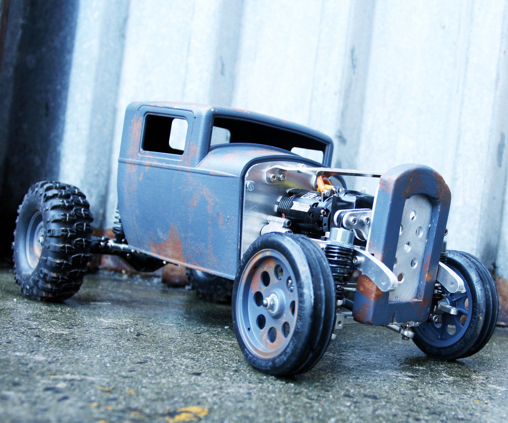

I have just posted an Instructable of my ratrod buggy with laser-cut aluminium chassis and SLS printed body. All the files (Fusion 360) etc. are there if anyone is interested.

@Brook_Drumm That is a good question, which I am perhaps not yet qualified to answer, but my first thoughts would be (a) larger print bed in at least one axis (b) ability to print nylon or similarly tough material © perhaps dual extruders for printing a soluble support material - I enjoyed designing without support constraints for the SLS nylon
I can do that!! Just need to build it. A modified dual plus fits the bill. I already have one w an 18" y axis just need to add another extruder. I have the parts
@Brook_Drumm that sounds like a useful machine, one could probably print a body like mine in two pieces, maybe even one (although it would use such a volume of support material maybe it wouldn’t be worth it… I have no idea how far it stretches/expensive it is)
@Brook_Drumm I’ll email you the specs!
In some cases it might be cool to break the body panels in the same places the original manufacturer broke them. Seam lines could be a feature. This would minimize support. You may be able to eliminate support by leaving the top open and printing the top vertically, perhaps even orienting the top square on its corner. It will be a fun challenge.
