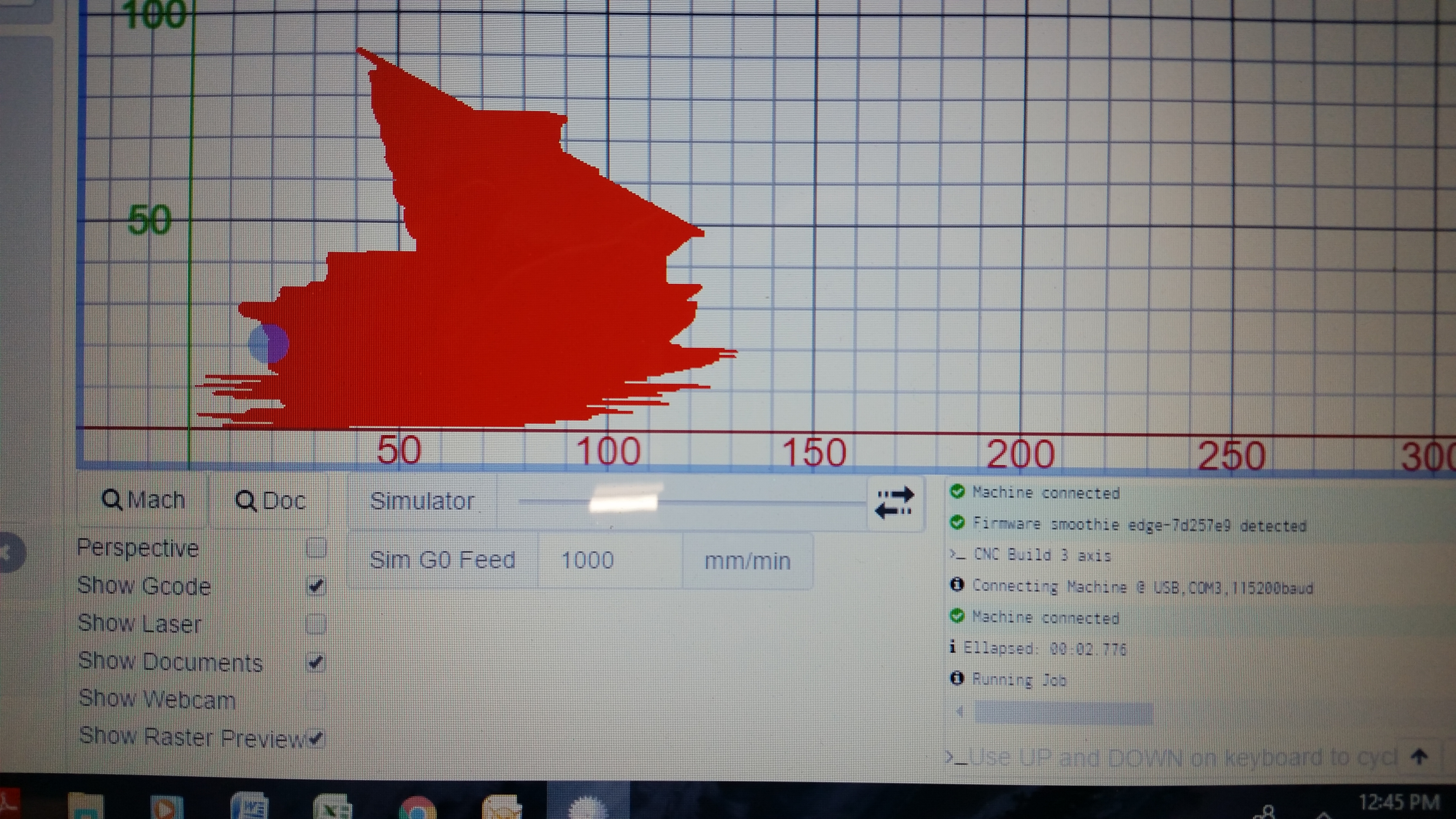

This usually happens after 3 to 7 min of the program running and I’m having to go back and completely restarting after noting the y axis position (Program is stating at the bottom going to the top). I turn the laser back on at the dropped off point. This happens about 70% of the time. I’m running at 4000 mm/min but have tried it also at 3000mm/min and the results are the same.
I’m using a Ferrite shielded USB cable is 2 ft long (I have four cables now) These pictures below show the screen at starting, when it just decides to miscommunicate and also the raster image which took two runs to complete because of stoppage.
