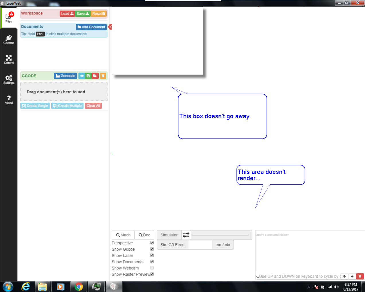

But, when I try to run LW4 on my cnc-laptop, despite being able to connect, I can’t actually use the software. I’ve added a screenshot. it’s as if the laptop is getting stuck on rendering or something. Any ideas?
Screenshot attached.
I’m guessing your notebook is fairly old (like mine) and doesn’t support the graphics driver needed to render in the browser.
I figured that’s what it might be. Figured it should be able to do a software render though…
I bummed so I would get the gcode using my desktop and then use the universal gcode sender on the old notebook.
Either @Vaden_Mohrmann ​ is correct or you have WebGL disabled
I enabled webgl in chrome. no dice. :frowning: I think Vaden is correct, but I wonder how I can force software generation instead of directx (or whatever hardware accelaration is used)
LW can’t do software render
