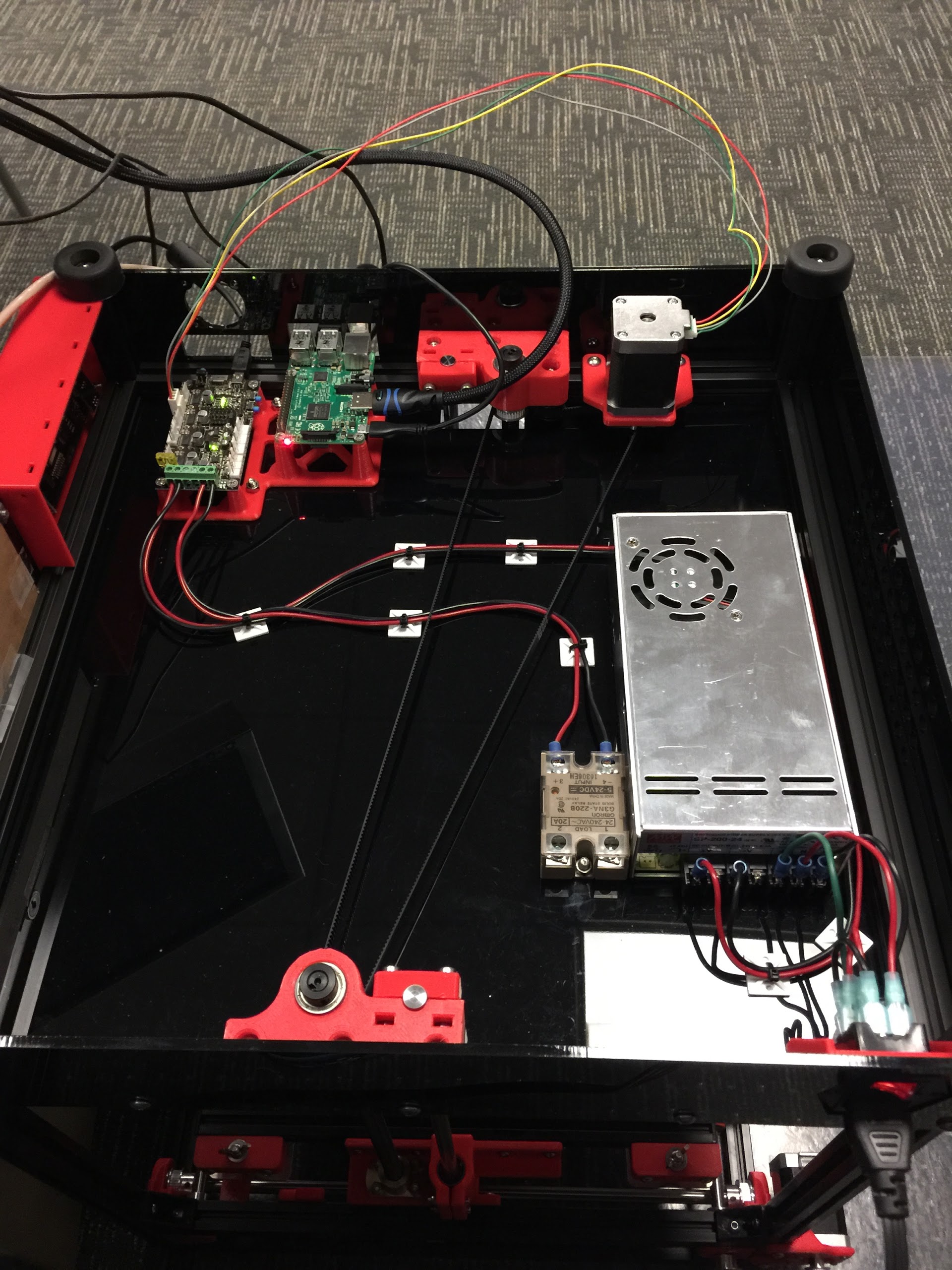

What do you think about the wiring so far? Good or bad? Suggestions?
Do you have your z end stop hooked up and have you clicked home? The controller needs to know where it is before it will move up or down.
