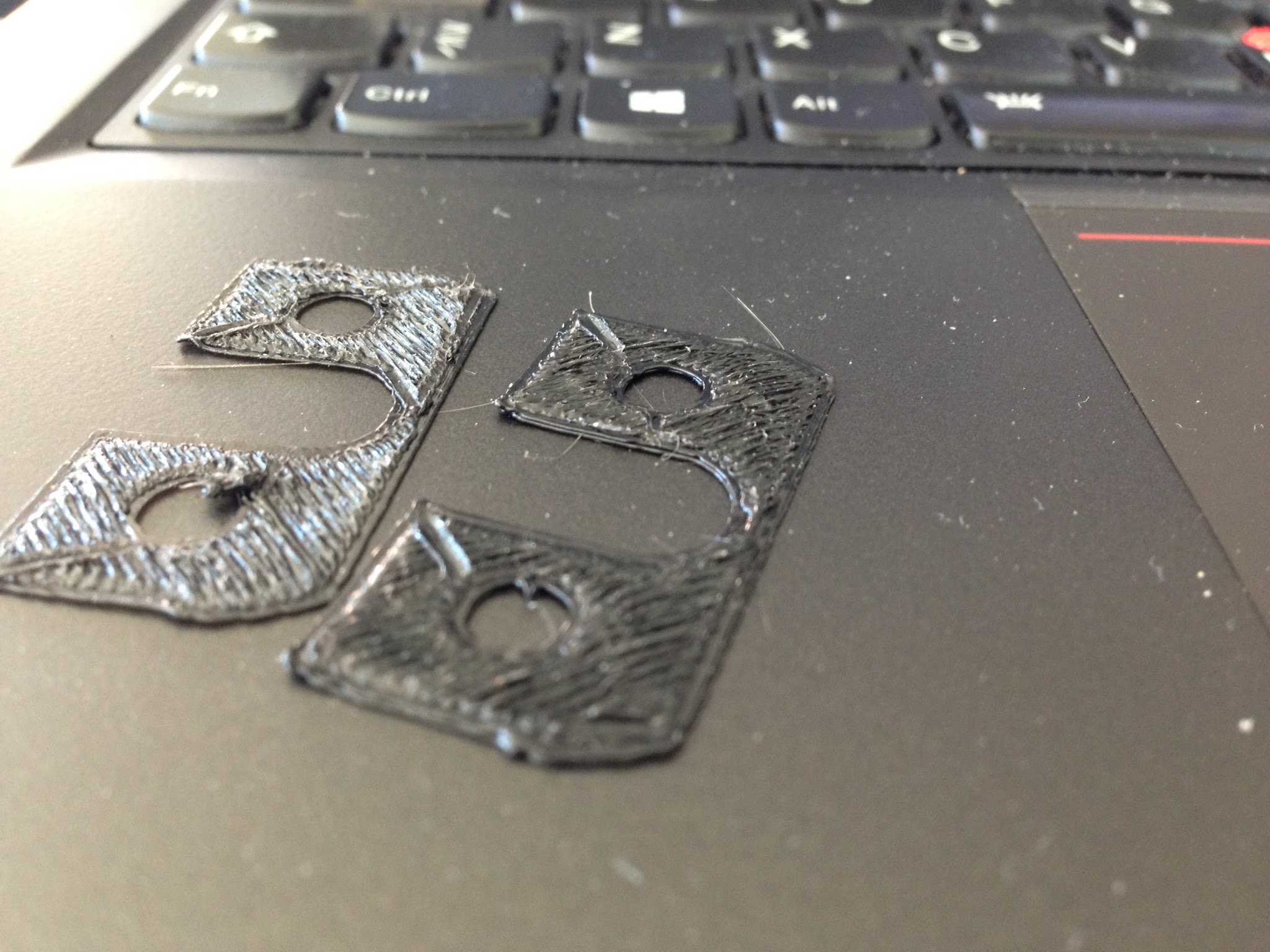

I have problem. when im printing its like the layer is getting to high, that so my nozzle hits the last layer when travel. Does any one know what is causing this?

i did run 100mm through and measured 99,8mm. i tried raising the temperature and the that helped a bit.
