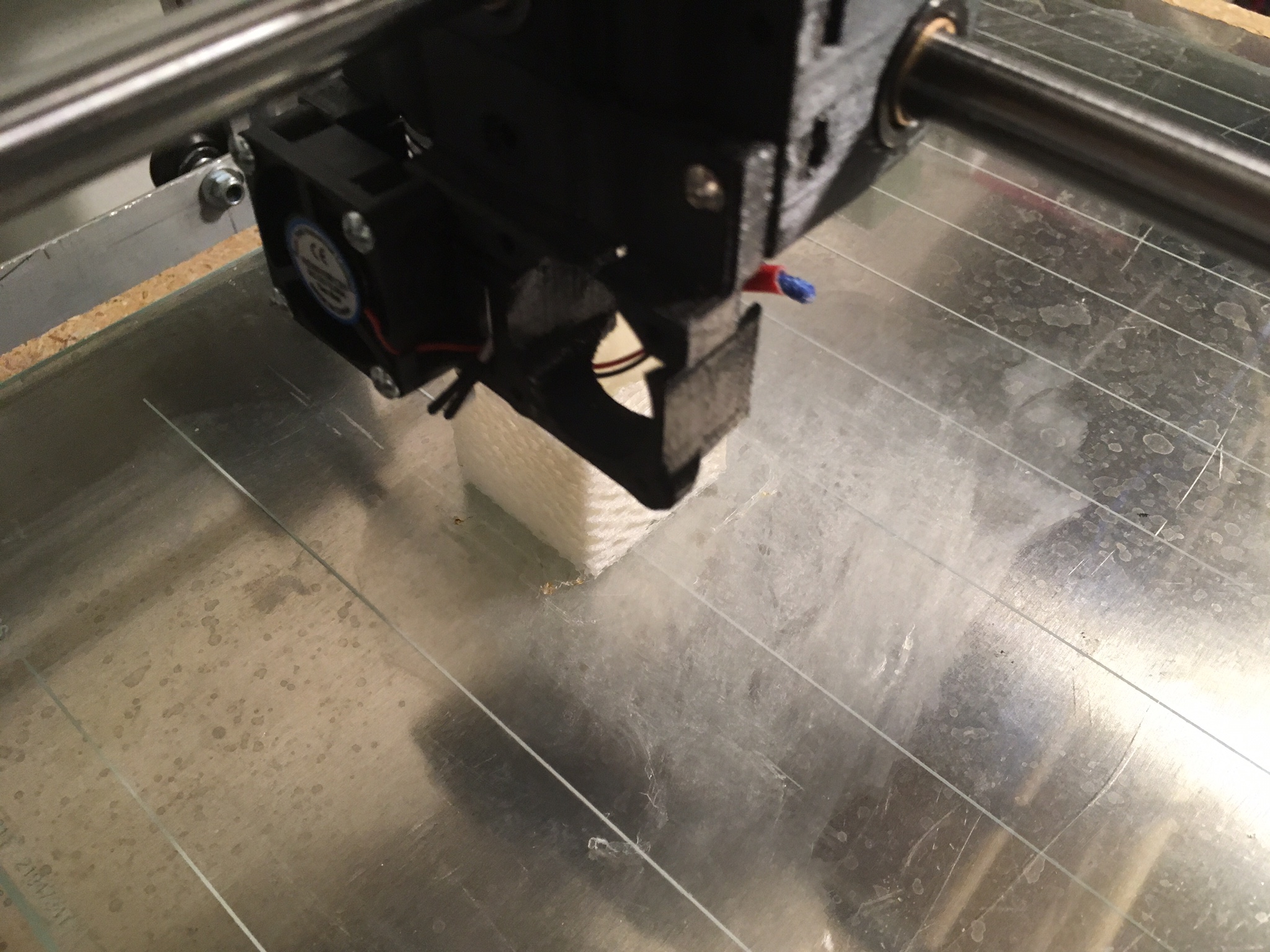

I have produced my first test piece, the 40 mm square cube, I I have missed something. The X and Y setup are pretty good they came out at 39.69; but the z axis is wrong, coming in at 20 mm which is half the height, I know I have missed a setting for this, but do I double my steps for z, or divide in half? #notgoodwith math

Thanks again for the advice, although this print has several problems, it is 40mm x 40 mm x 40 mm! Real progress!
