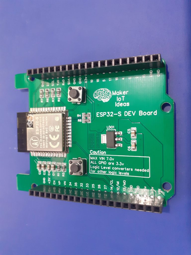

ESP32-S Dev Board Rev 1.0

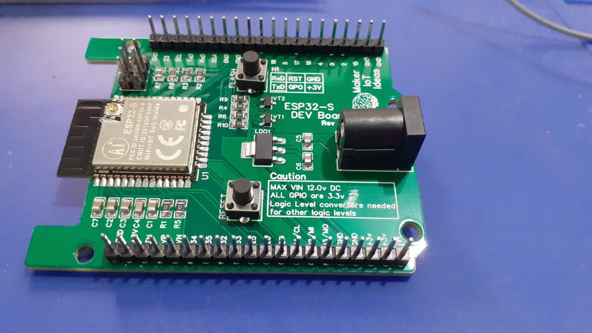

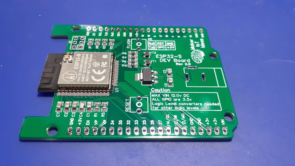

ESP32-S Dev Board Rev 2.0
I have also decided to use male header pins on this build, as I sort of like to use them more than the female ones ( which seem to develop connectivity issues after a while – this could be due to the quality of the connector strips that I bought)
What changed, and how?
I made quite a few changes, most of them quite subtle.
The most obvious would be the addition of a DC Barrel connector, to allow the device to be powered easier when used as a permanent project. In addition to this, a 6-pin programming header was added, in order to make flashing the device with an external USB-to-serial adapter easier than usual. ( This means that the standard 2-transistor reset/flash circuit was also added). That meant a slight increase in the component count. Additional decoupling capacitors were also added to add voltage stability to the ESP32-S. The routing of the entire board was also changed, with more attention being paid to the heat dissipation of the ESP32-S module, which tended to get a bit hot.
Power is provided by a 3.3v LDO regulator, the same as in the Rev 1.0 hardware.
I do plan to change this to a small buck converter in the near future, as the 800mA provided by the LDO regulator can get a bit limited, especially when using I2S Audio devices, something which I am doing quite a lot over the last few months.

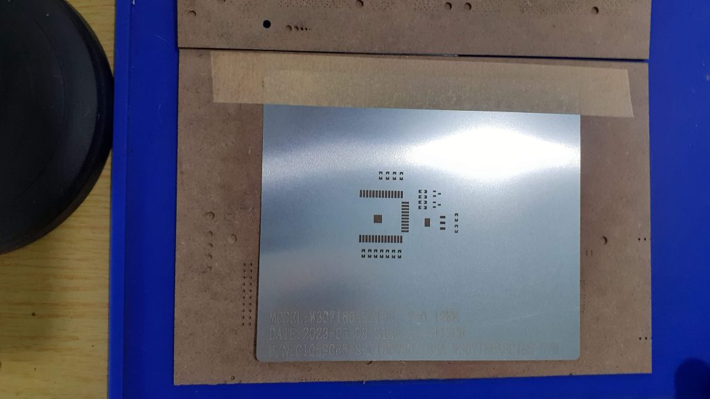

This PCB will definitely benefit from using a stencil, but it is not strictly necessary. I did however get one, as I prefer the uniform solder-paste application and speed that they give me.
Stencil for SMD assembly
Component placing took only about 10 minutes in total, including the time needed to place and use the stencil, apply solder paste, select components and place them in their correct positions.

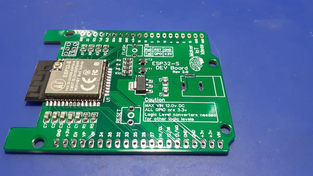

After Solder paste application – Before reflow soldering
The board was then reflow soldered on a hotplate at 223 degrees Centigrade.
After Reflow soldering
The board was inspected for solder bridges and bad joints, and I then proceeded with through-hole component assembly, which took about another 10 minutes.

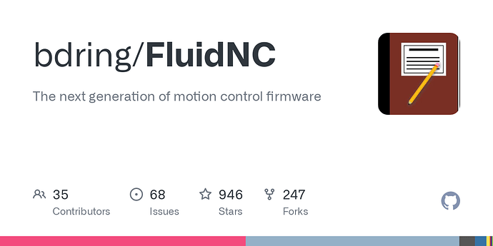

I have a suggestion; if you want to make a MKIII version of this it might be a good idea to add a SD card reader slot (which can be optionally used), connected to the default SPI / SD pins.
I use a ESP32 based controller in my Mini-CNC, which has two ‘tool’ modes (laser and spindle) with two separate configs, I use FluidNC on it and a SD card is needed to host configs, gcode and the Web Interface.
I’ve been leafing through the FluidNC documentation, it’s all been updated since I last visited. There are two very useful pages there for anyone thinking of ESP32 based controllers:
Looks interesting, Thank you … will take a detailed look today
