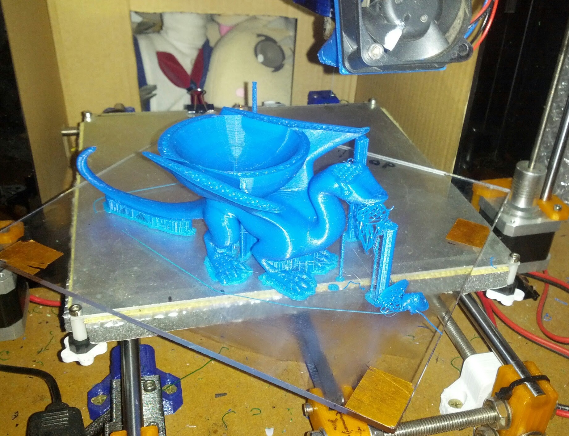

I have so much bad luck printing this dragon! Falling over supports,
Falling over supports, problems with overhangs… I’ll get the hang of it though!
Edit: tried again after running it through meshmixer… Another fail… This dragon hates being printed…

Use a raft, smaller supports and more of them. Supports are not sticking to the bed and a raft will help that

@Doug_Rector The blue one is the newer tries and it sticks /very/ well to the bed. But slic3r’s supports seem not quite good enough for this. The fail was between the top of the support pillar and the tip of the dragon’s muzzle.
