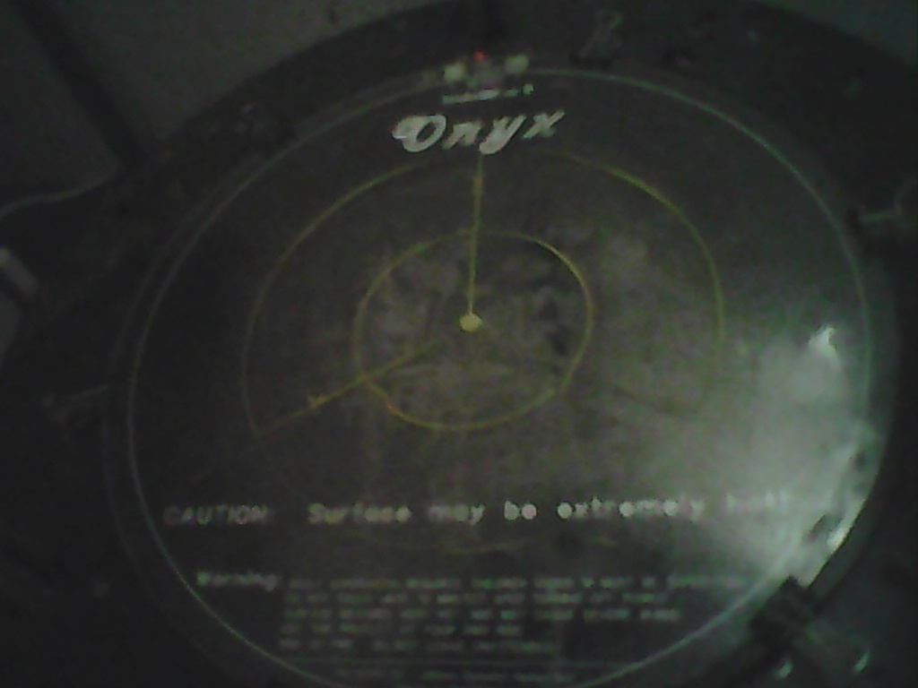

I have the feeling that all sorts of tings are wrong with my printer, but hopefully it will behave anyways. My do-it-yourself delta arms, a warped heated bed, possible tilt in my hotend and an uneven frame are all possibilities here. Hahaha
Oh boy… :frowning:
The weird thing is, it still prints fine in the middle area. I dunno. Maybe I strayed from the original arm lengths and need to do inner vs outer calibration. At any rate, it is making me a set of 6 rod ends that I will need as spares sooner or later.
Deltas simply require a bit of forethought and planning in order to keep everything 100% straight. That, and grid-based bed leveling. :stuck_out_tongue:
Yeah…maybe I should upgrade with a touch probe for “scanning” and bed leveling…and fix the frame and heated bed and…hell…replacing the whole thing with a built from scratch might be an idea…
Your bed may be warped, but I’d bet the glass is flat, so that part really shouldn’t affect anything
I have a bowed rather than warped bed, luckily the centre is bowing upwards so I plan to cut an aluminium disc to bolt to unused mount holes to help flatten it and also act as a heat spreader.
@Taylor_Landry
Hmm that might cause a few “cool” spots, but that can be remedied by placing cork (or any other insulator) underneath the heater to push it up flat against the glass…
