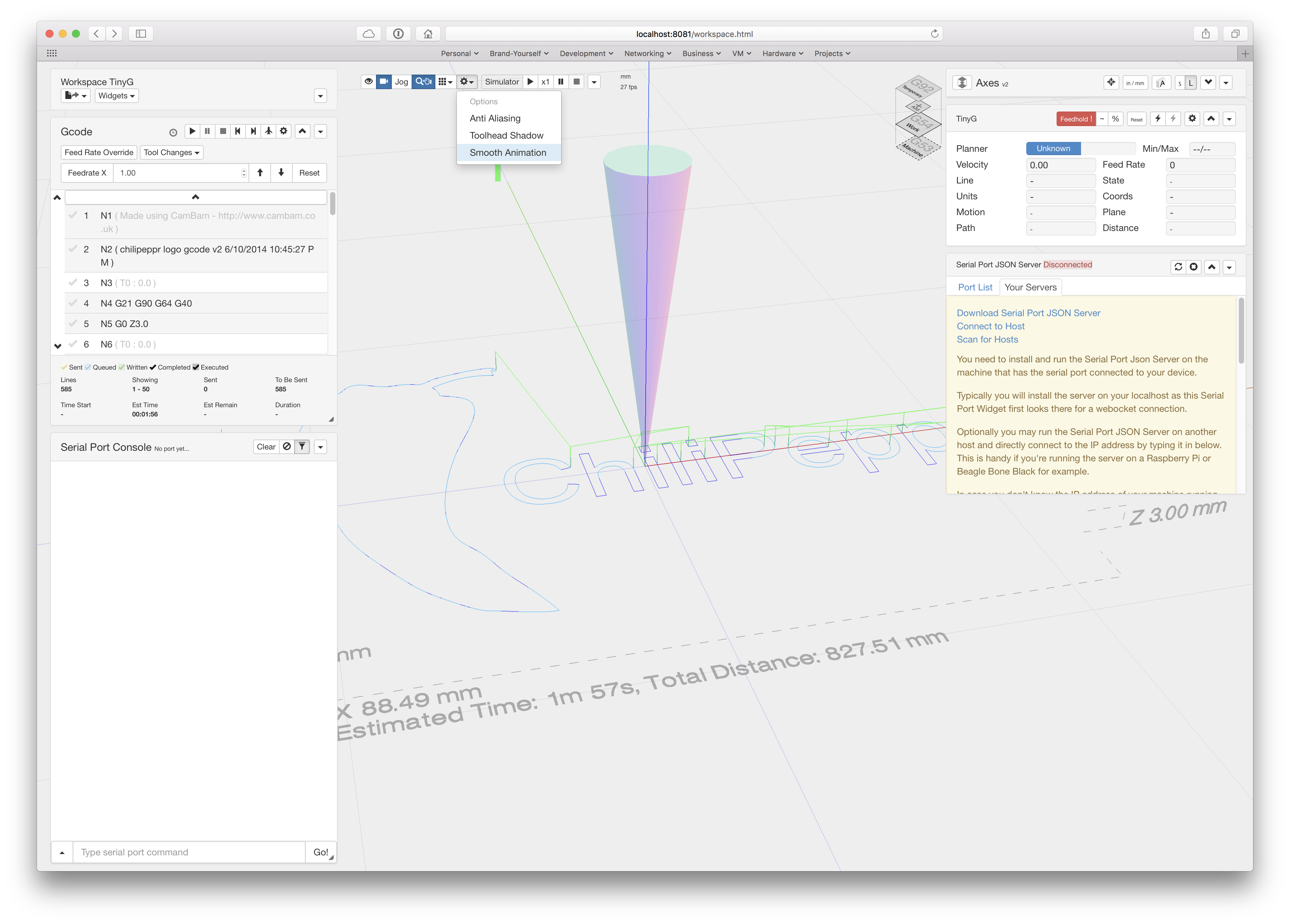

I have the tinyg workspace working with my optimized 3d viewer. Autolevel and Cayenn plugins break things, so they are disabled in my tinyg workspace until I can spend some time updating them.
Some performance notes, I have a new 13" macbook pro, 3.3ghz 16GB of ram, but it only has an Intel Iris 550, driving an LG 27" 5k display. Full window view for the 3d viewer is not fast at my resolution with AA and Shadows on, it seems totally fine with both disabled. Running in my Raspberry Pi workspace with AA disabled, shadows work just fine. There is definitely a big performance hit by adding in all those extra hidden pixels behind the other widgets.
