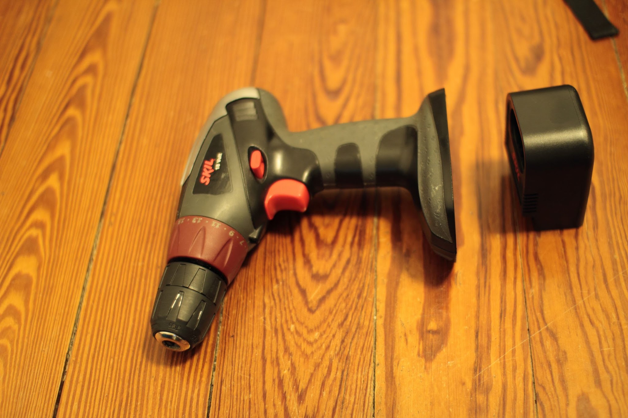

I have this drill SKIL 1003 18V, most of the time I can’t use it because the batteries are dead and they didn’t keep the charge. Before to throw it, I will try to make it work without batteries, linking the charger to the device by a 3d printed ‘bridge’.
I will print it tomorrow and try.
Do you think it can work?

Have you tested the electrical design? I think you will be disappointed. While the voltage will be within tolerance, the current most likely won’t be. I’m suspecting that under load the drill will demand more current than the charger will be able to deliver and it will stall.

But don’t connect the charger direct to the drill - battery chargers are usually quite complex and are designed to send current pulses to the battery depending on the level of charge it senses. The charger’s output current waveform will not be suitable for powering the drill directly.
To connect that drill to the mains power you will need an 18V regulated DC supply, which is totally different to a battery charger.

Thanks everyone for your opinion, my aim is not to get back my full power drill but to have a working device without to spend a penny. I will buy a cordless power tool later. SKIL will drill only some soft material (plastic and maybe wood…). So today I try to wire and to drill some PLA with the standard charger, it works slow but it works. I felt a bit stupid when I read on the charger 400mA and on the battery 1.2 Ah. I have a lot of charger (but still have to find them…) and maybe I will find something better. I have some powersuply for notebook but it’s arround 4.74A (maybe SKIL can fly). My initial project was to use the charger dock to bridge it with the drill but, but it’s not work. Inside have have a electronic board so I will cut it and link it directly to the F switch so I will never can use it again to charge baterries. (sorry for my english)
I just got an other freaky idea, why to cut the board? Maybe I just have to 3d print a new bottom caps enclosure to connect to the drill and charge the battery in the same time…“c’est n’importe quoi” but I will do it.
I just try to wire it and it’s working.
