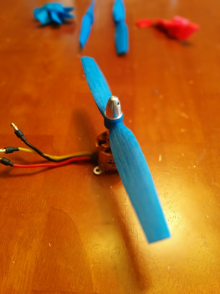

I haven't released anything yet, because I haven't spun it up yet.
I haven’t released anything yet, because I haven’t spun it up yet. I need to get a reasonably detailed stress calculation done before I spin this up to speed; which I’m working on now. Safety first.
Just discovered the DOF feature on my phone camera. :wink:
I cant wait for you to release the files! This prop looks amazing

Alright, the code now reports the stress along the blade length due to centripetal force. It looks like this propeller is well under yield strength at the RPM I’m going to operate at (10,000-15,000 RPM). Looking at a factor of safety of about 2.8.

Well, balancing the prop isn’t a problem if its printed solid. Sanding removes material till balance is achieved.
Whether each blade produces balanced lift/drag loading in operation remains to be seen. Vibration may still be a problem.
Keep you posted.
I spun it up and it almost made it to top speed when the hub started slipping. Will try again tonight.
