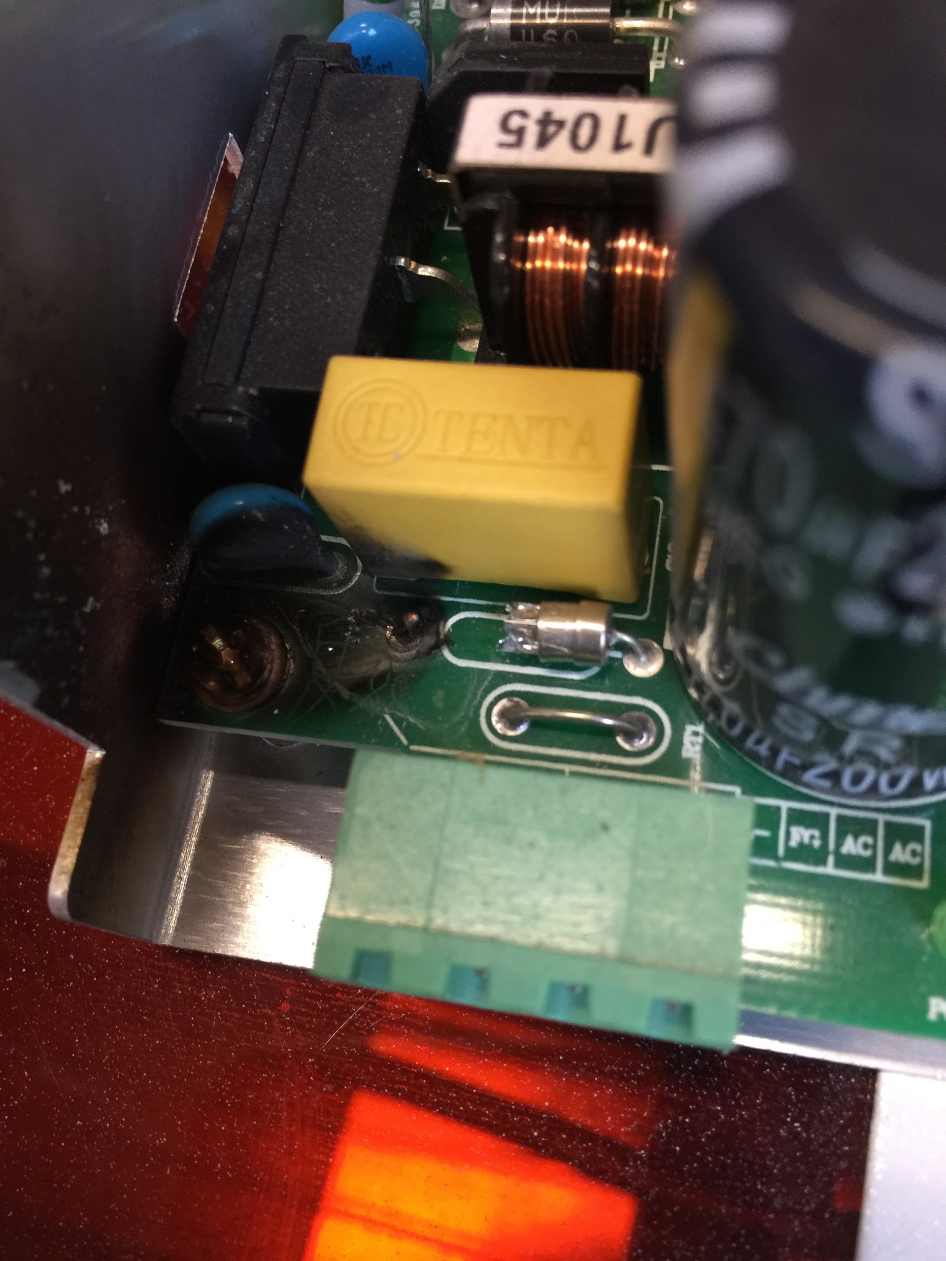

I hope is not completly dead,tomorrow i need to replace fuzz in my psu
I hope is not completly dead,tomorrow i need to replace fuzz in my psu and see whats happen.
Why its always like that when you get all to work(smoothie,display,full power spectrum)
I need right rating of this fuse,so if any have ,can it share please?
What PSU do you have?
MYJG40W, i think its old type with separate fire and pwm pins
The fuse should be on the Neutral wire of the mains, So if it is 220V, a 3Amp fuse should be about right. Easy way to check is to solder in a fuse holder, put in a 3A fuse, power it up and see if the fuse blows. IF it doesn’t then slowly raise the cutting power to maximum, if fuse does not blow, you should be good to go, if it blows try a 4A fuse. I would not raise the fuse amperage to higher than 4A without knowing the actual original rating.
Im wondering,maybe it was overloaded,now i wil try to use separate psu forsmothy and motors and separate for lasertube.finger cross fuse holder soldered,now time for tests
No lucky,4a fuze just blow off,looks like psu is dead. Now jow to disconnect lasertube?just cut red cable from psu or other way?
PSU may not be dead, there may be a short circuit in your wiring. Doublecheck all connections before doing anything else.
I checked all,there was no connection to psu except main,so im sure there is no short circut at all.
Laser tube looks fine too
You can always try a 10 Amp fuse, at this point you have nothing to lose, if the PSU is fried, it will not make things worse, if it works then problem solved.
Not sure about this,because i point when fuzz in psu gone my mains braker in house gone too.i already wrote to my k40 seller and se said they know about this problem(so looks like im nit first) and they i think will send me another psu.
But im wodering about it can be made by laser tube?i mean laser tube burn psu?
In very rare cases a bad laser tube can damage a PSU. But very unlikely. I would now wait for the seller to send you a new PSU
