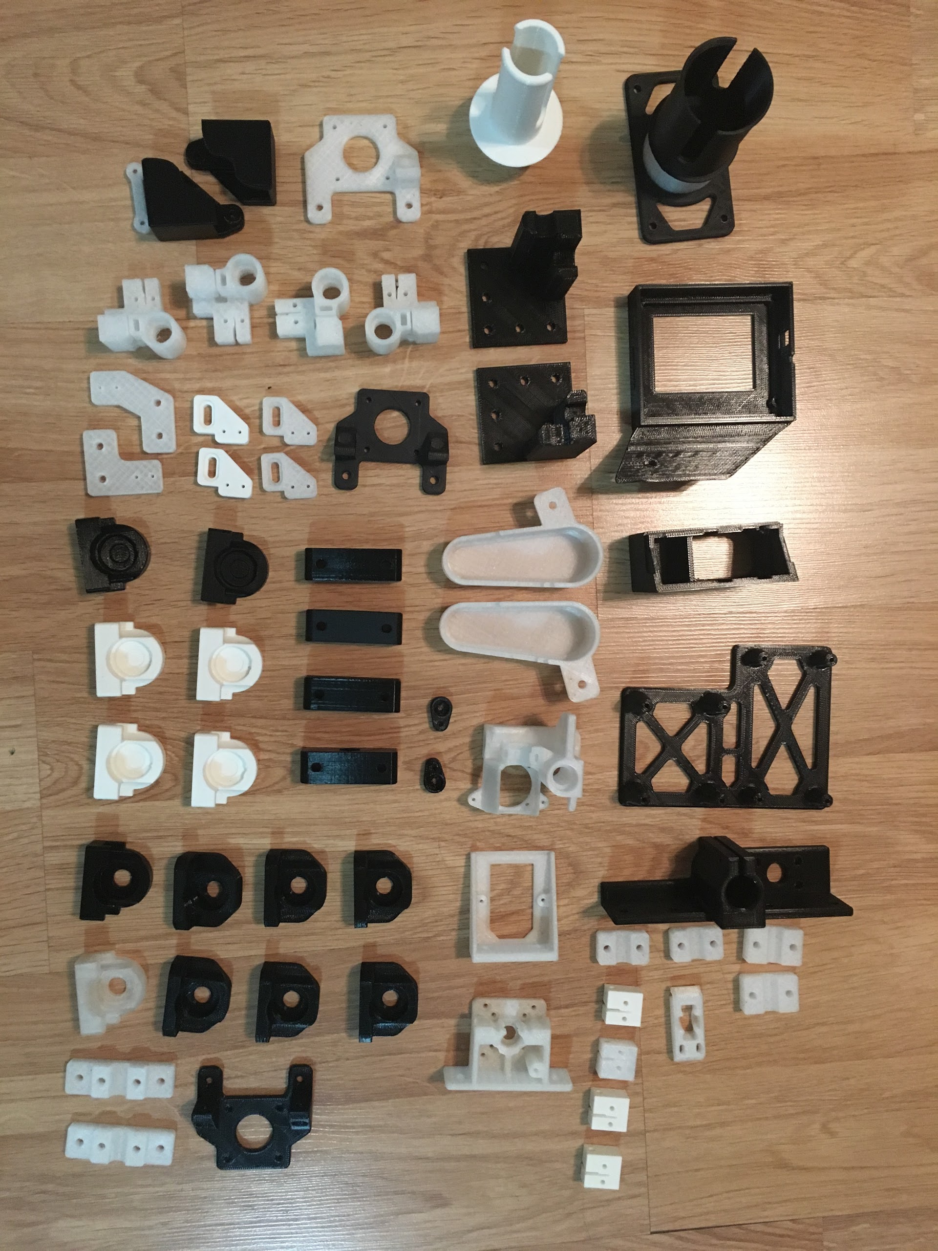

I hope it’s all I need to print … Haha
Good work. Missing a mount for your X (or Y) moter. Can find only one. Some for the bed mount block (can find only one). You have sufficent passthrough bearing holders
Here is what you need: https://raw.githubusercontent.com/eclsnowman/Eustathios-Spider-V2/master/Documentation/Pictures/Printed_Parts(Black_With_Hercustruder_Extruder).jpg
Here it is without the extruder: https://raw.githubusercontent.com/eclsnowman/Eustathios-Spider-V2/master/Documentation/Pictures/Printed_Parts(Yellow_No_Extruder).jpg
Btw if you use the GolMart ball screws you need Walters bed mounts instead of mine: https://github.com/eclsnowman/Eustathios-Spider-V2/tree/master/Community%20Mods%20and%20Upgrades/walterhsiao/1204%20Ballscrew%20Bed%20Support
