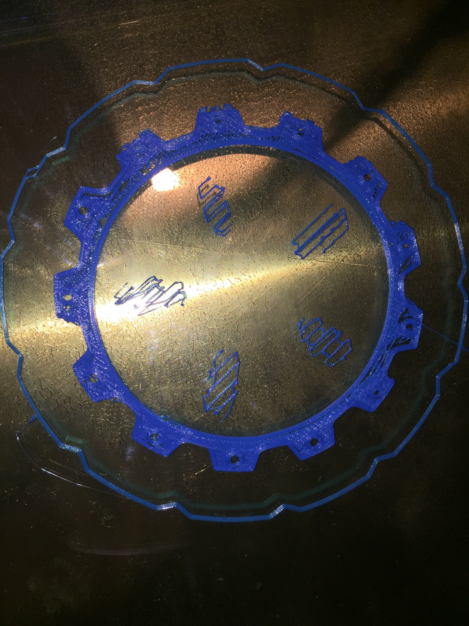

I tried printing a different (simple) part. Dropped the steeper current back, drop the print speed to 50mm/s. In these pictures I dropped the layer height to 0.1mm.

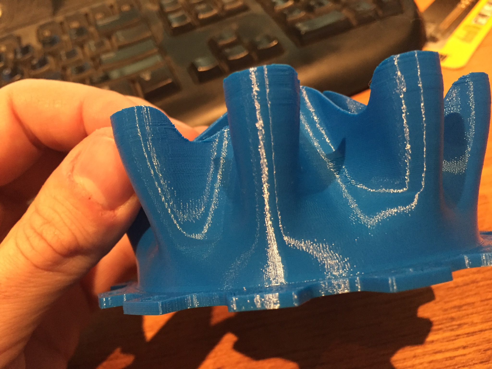

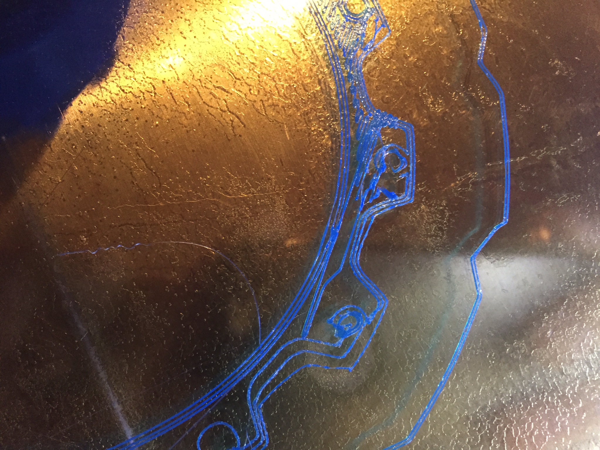

I had issues with variations of the layer accuracy in the first part. Some regions of the part printed good through the various layers while other regions were obviously not putting the part profiles one on top of the next. I also had one of the center support pads/towers have issues also. The initial layer of the support pad was in the correct location while subsequent layers where printed in a much different location.

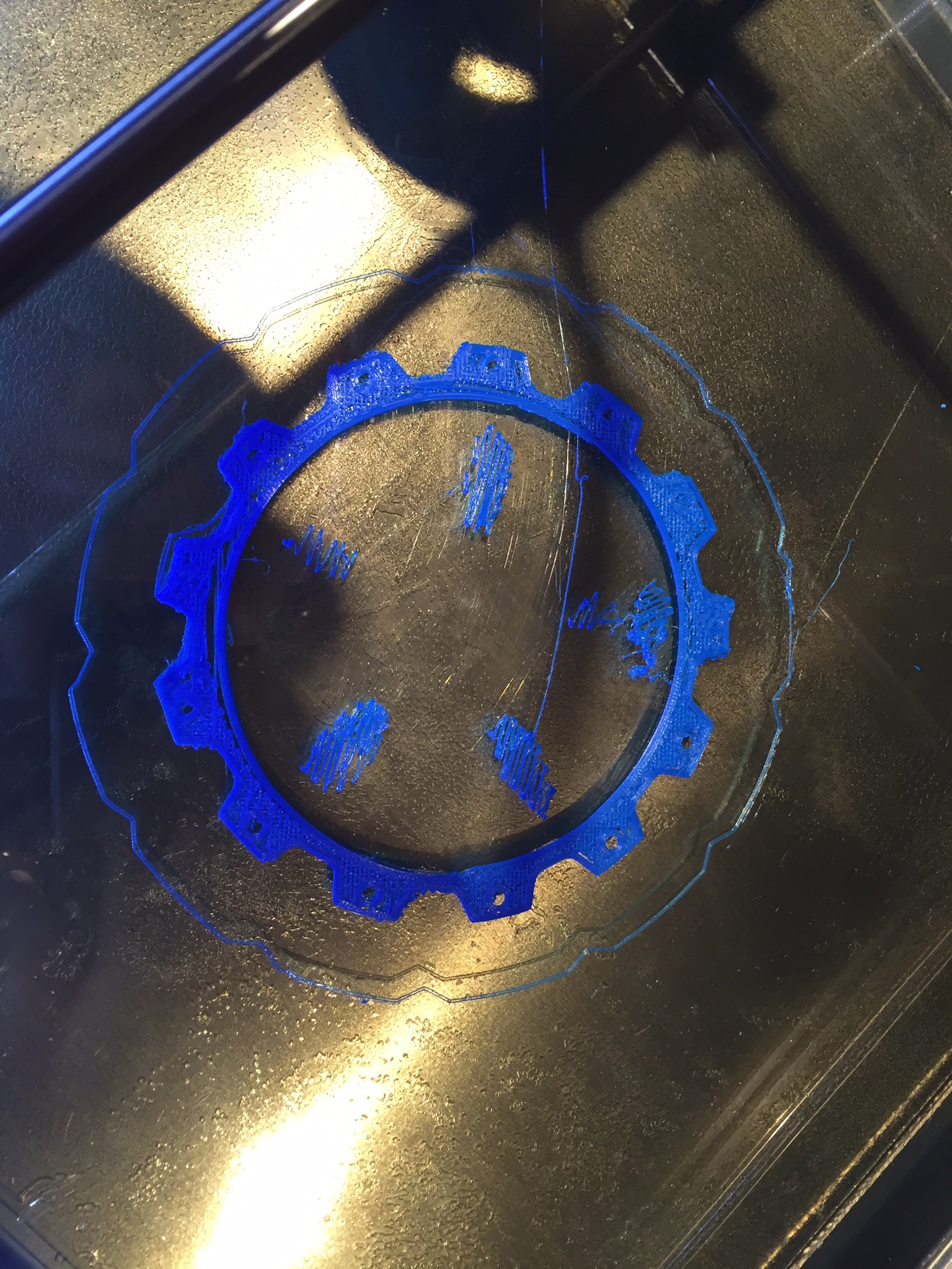

Then using the same code I tried printing again and got results that in some ways were similar yet different in others. The net result was the same in that areas of the print turned out well while other areas just couldn’t seem to print the layers on top of the correct spot in a repeatable manner. It did print the support pads in the correct locations the second time.

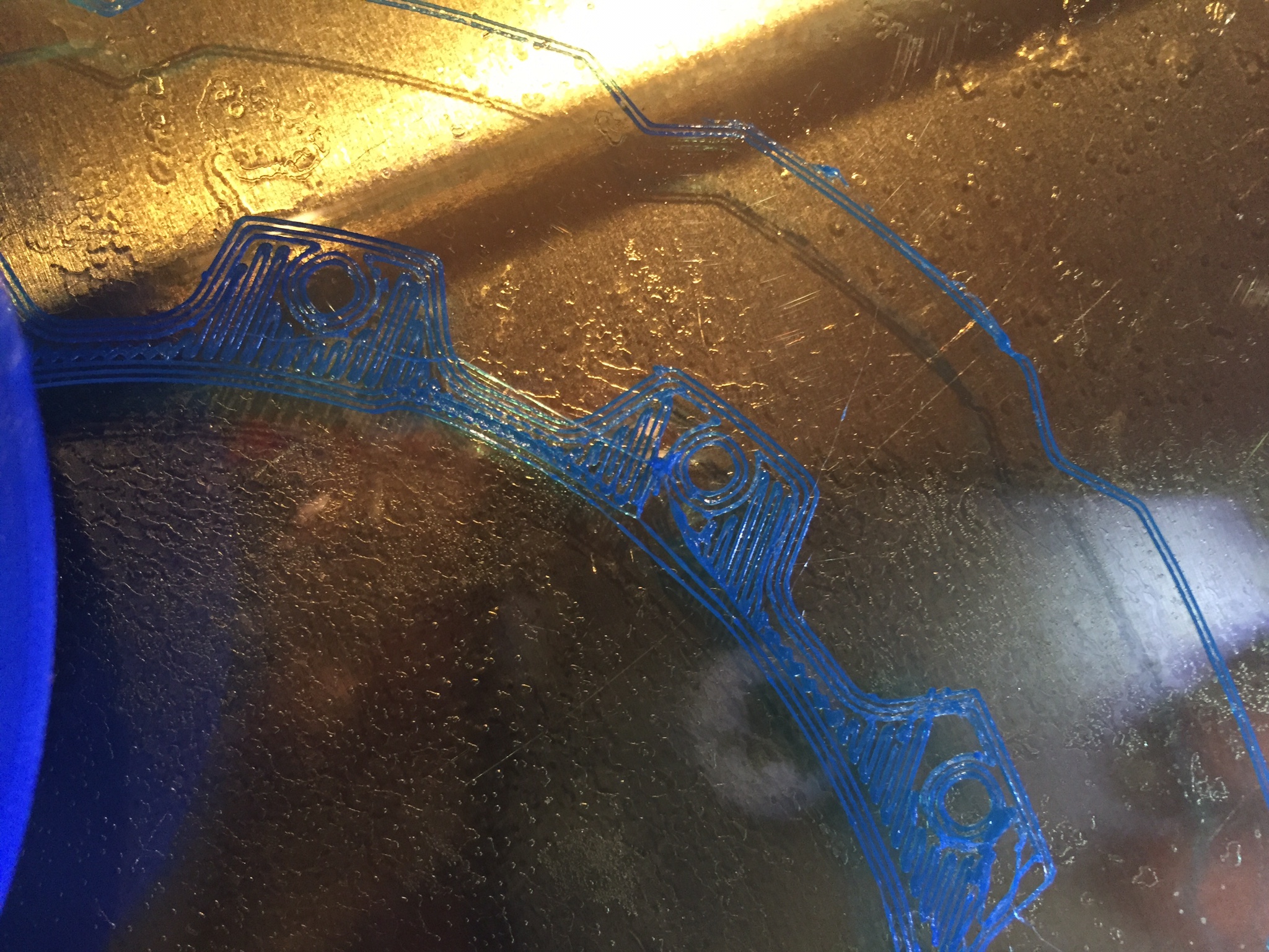

I’ll include the pictures of the first print here.
Last pic of the second print, same code as the first print. I can’t figure out if this is a stepper issue, or a driver or if it’s something all together different like simplfy3d or the controller itself?

@Mike_Miller hi Mike, my issue here isn’t the quality of extrusion, it’s a randomness of positional accuracy… if you look at the printed parts you’ll see places where the layers line up one on top of the other and then other places where they don’t, and it’s pretty repeatable also.

@Bruce_Lunde hi Bruce, I think my first layer is under extruding for sure. I’m going to tweak the first layer width to see if I can get it to fill in some. I decided I’d try switching stepper drivers around. Swapped the Y w/ the Z driver. I also found one set screw (of the two, second screw was tight)on a pulley which was a tiny bit loose. Fired it back and it’s working. Not convinced the screw was the issue, would tend to think it was something w/ the driver (connection or something) that was the issue. Will keep banging away at it. I’m not near done tweaking the settings but until I can get reliable and repeatable motion, no point in messing w/ simplify3d.

@jerryflyguy looking much better. I think the set screw was your root cause. You weren’t exhibiting standard layer shift… But more of a sloppy skew in the print geometry. An area to watch for is circles, watch for an out of round tendency in circles. If you see that I lean towards mechanical issues.
If instead you see consistent layer shift but the geometry still matches the layer below then I would look for nozzle catches or stepper/driver thermal throttling.
