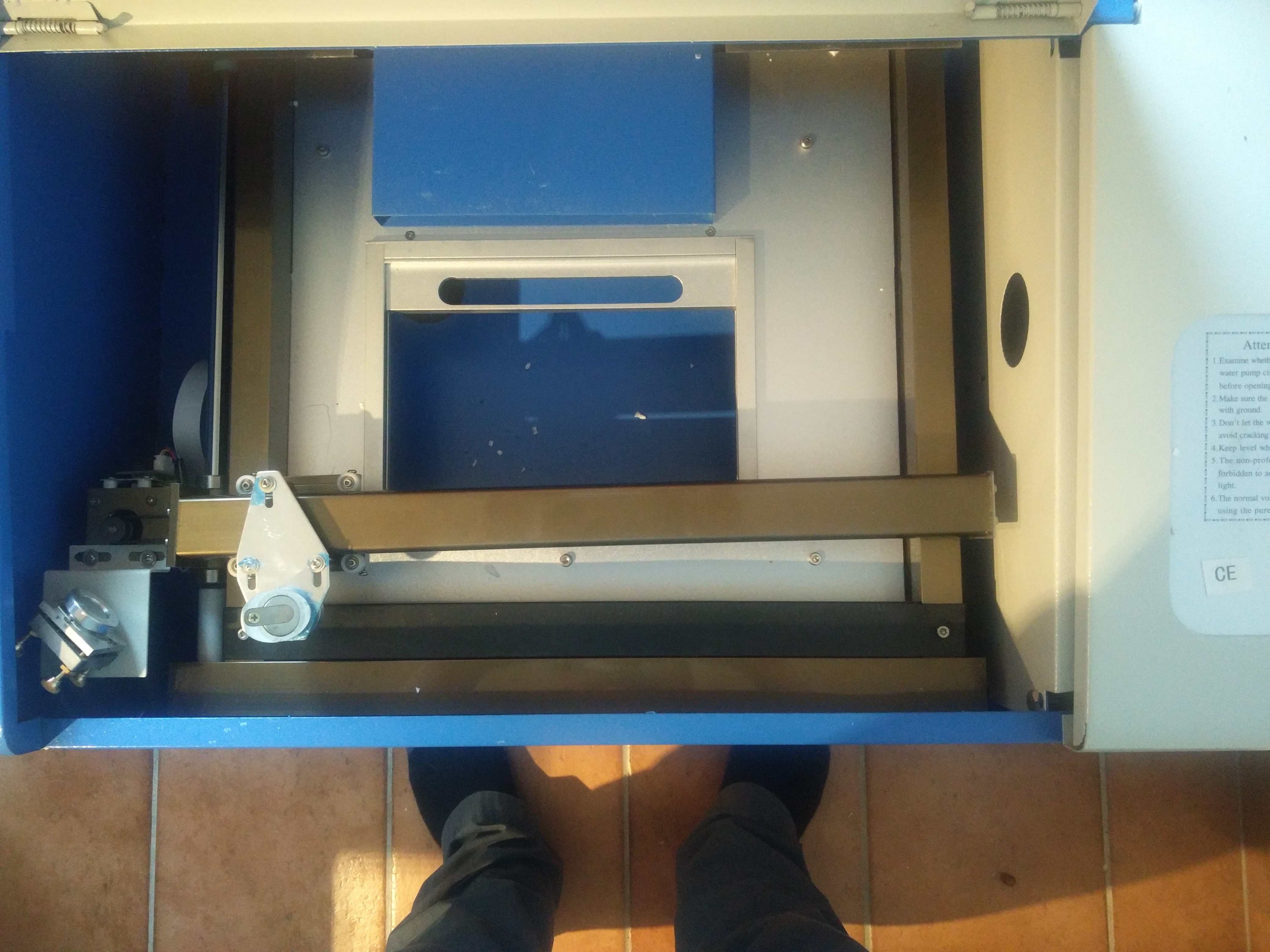

I would love to get on with the next thing: how well is it going to be drawing a line, when the X axis bar is almost 5 degrees of :slight_smile:
What OS are you running and it looks like you need to take the rails apart and reassemble them to be square. Contact your eBay seller mine gave me 75.00 dollars because I had a ding it it that knocked it out of square the way it sits I’m thinking you got some work ahead of you before you can get it cutting

I would agree with Corey also, your Y axis looks well & truly out of square. I also got a refund from my seller for issues (mine wasn’t damaged, just alignment was impossible due to the way they mounted mirror #1, which was solved reasonably easily). I will check my install CD that they sent me later on (when I have an available USB port to plug my DVD drive in) to see if I am right regarding the .inf file. Or if you beat me to it, take a look by right clicking the .inf file for USB driver & try install it that way.

Interesting. I have that same controller, but it came with LaserDRW and I was told RDWorks won’t work with it. Huh. Anyway, as others have said, you have some manual work ahead of you to get the rails and gantry squared up. That was the first thing I did when I got mine. I lifted the whole thing out of the machine (4 bolts hold it down), then took it all apart and squared it up. Some of the metal bars were bent out of shape as well.
